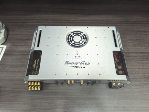

I'm new to this forum, so hopefully I'm going about this right. I came across this item and really don't know much about it other than it's a car audio amplifier. I have no idea if it works or how to determine if it does. I tried to upload some photos but couldn't get that to work. Any info is appreciated... thanks

Thats a Classic sought after amplifier. You can do a quick test at your car Battery to see if it powers up or not. Poss/+ to Poss/+ and Negative/- to Negative/- and Take a wire and go from either Poss/+ on Amp or Battery to the the remote section. Give it a couple seconds for amp to click to come on.. @ Power LED light on top (Three dots)should Light up Blue , and should at least be ready to test further on the bench or in a vehicle where there is 12v of power and an HU and speakers.
