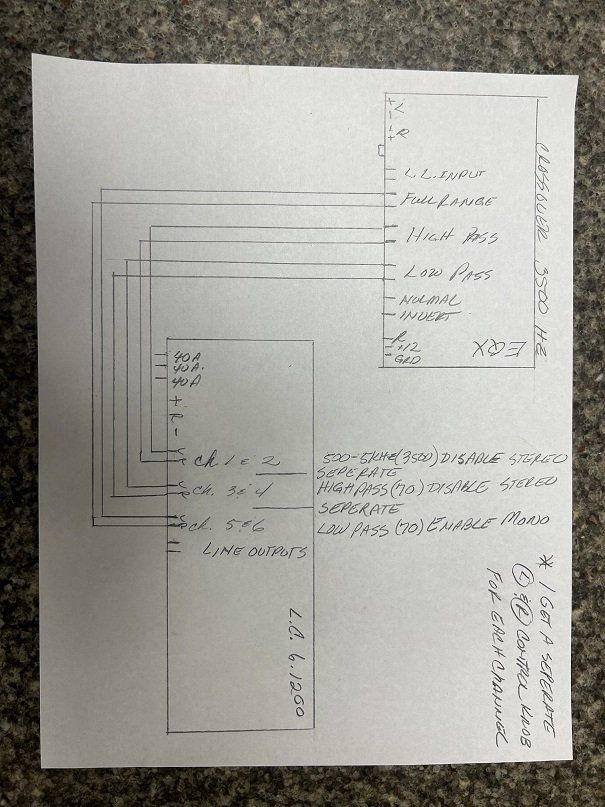

I have an Audio Control EQX I'm wanting to hook up to an Audio Control LC 6.1200. I can't afford the DSP yet. Can I hook these two up this way to get a separate level control for each speaker for some tuneability?
Would I still have Full Range out of the outputs of the LC 6.1200?
Thanks
Thanks
I would put the full range to ch.3&4, and low pass on ch.5&6.
The 6.1200 line out should be full range unless it has a dedicated x-over. In that case, the x-over should be defeatable.
This is in a 2015 F150 regular stereo and I'm using the front speakers for a signal. The EQX is hooked up speaker level. I put a cheezy line...
