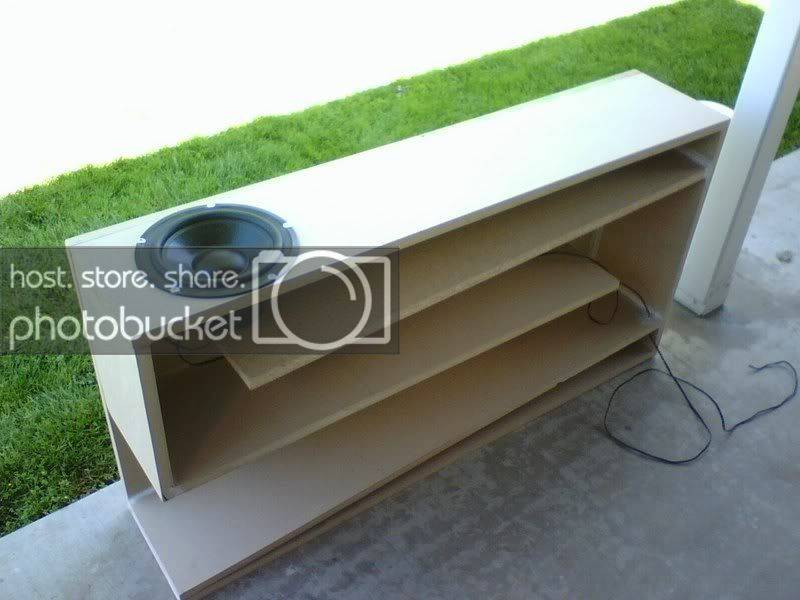

I used this thing years ago in a positive taper transmission line for efficiency. Only 25 watts was enough to rock the apartment. Indeed, a great subwoofer for the money. Very well built, though a cast frame would have been nice.

I didn't have it playing to high, since the ripple in the midbass region was audible to me
I believe I had it crossed over at around 50hz...
I dont have the model anymore, but the ripple started around ~70hz I believe and the response was down -3db at around 26hz, better with room gain (it was in a corner).
It was mechanically limited to ~25 watts, so I had the parts express plate amp on it. It was pretty controlled with music/movies though. Lot of rumble. I have the dimensions, but be warned. Its basically a coffin since it has positive taper (think horn). Great for a small to medium size room:
As you can see, it was down firing coupled to ~1.5 inches off the floor. That was in my parent's house, which is pretty large. The living room is ~22 x 27 and is open to the kitchen, so ~22 x 39 I think. It had no problem filling the room at low to moderate listening levels. In my apartment, which was roughly 12 x 18, it had plenty of output.

Do it, wood is cheap //content.invisioncic.com/y282845/emoticons/biggrin.gif.d71a5d36fcbab170f2364c9f2e3946cb.gif Its about a full sheet or so. Maybe less I don't remember. People think its way more than an eight and 25 watts...
