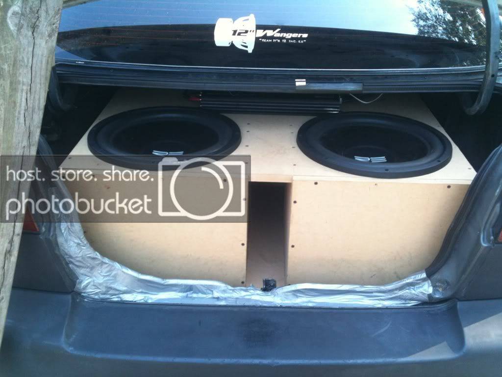

Pair of lanzar opti 1535d's in civic can beanasaurus do it ???????
Its copywritten so you have to pay me royalties if you plan to use it.
Well I don't know the exact label for it, but the idea behind it is basically a ported clamshell. I have read that with clamshells, once the baffles reach a certain angle it turns into a 4th order. Thats why I said I'm still researching things....
excuse me for not using proper terminology //content.invisioncic.com/y282845/emoticons/*******.gif.a649d21efc0d1fd4890a6428166586c1.gif
I'M running my 1535d's in a 7.5 cube net wall tuned to 35hz with about 130 sq in of port. It does well even only on 2000 watts. Tried it on about 4500 Watts but one of the amps said F_that.
Went to an iasca show over the weekend and bassboxed a 142.8 DB ( 30 sec average)
how is this a 4th order and wheres the sealed chambers?
A plain old 4th order is just a ported box. It's different from a 4th order bandpass. If you left the backseats in it would be a weird version of a 6th order where the port leaves through the sealed chamber instead of through the ported chamber
