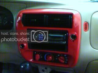

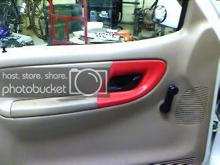

believe it or not i used rustolium spray paint but i prepared it right 2 layers of adhision promoter, sand , 2 layers of priemer (sanded in between), 3layers of paint, samding in between, and 2 coats of acrylic laquer,
