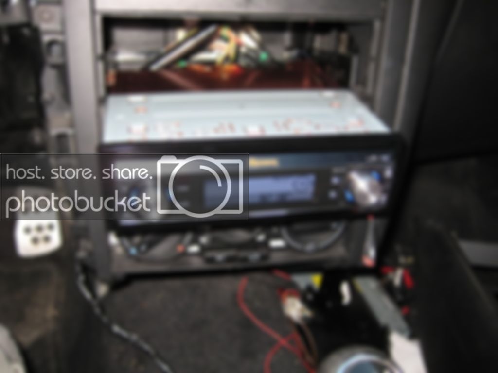

Alright folks I installed the p800prs this afternoon and the screen was flickering back and forth. If I let a cd play, dont touch anything, after about 30 seconds, the screen would change from normal to like a white display. I'll post up pictures explaining this shortly.
What could be causing this? I didn't hook up the illumination just to avoid these things.
please helpppp //content.invisioncic.com/y282845/emoticons/smile.gif.1ebc41e1811405b213edfc4622c41e27.gif
okay, this is what it normally looks like
[/img]
here is the "flicker" which will last for about 10 seconds, turn off, then 30 seconds later, turn on again
when i first installed my 5900 it did that. i turn off the reverse mode and demo mode under my settings and it stopped
