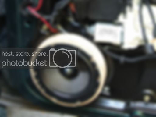

Mk4 Jetta.....A-pillars and the mids are pretty low in the door. Door is matted but I would really like an enclosure for the mid...it plays down to 60 very well but I know i'm losing a ton of air through the swiss cheese door.
While on topic...has anyone successfully built a small enclosure for the front mids? There is alot of room in there, I had to space the speaker out about 1.5" to get near the grill.
Before the matting:
They sound very good, played with the x-over looking for some distortion and it sounded a bit like a plastic bucket crossed at around 70-80 Hz...prob cuz of the enclosure but they really cleaned up around 55-60Hz, and hit pretty hard.
