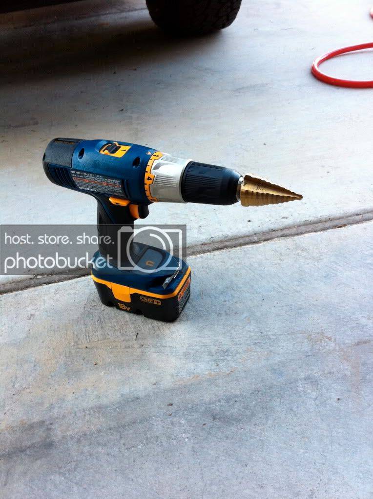

Drilling through the steering wheel may create airbag issues, not to mention it may be difficult to hide a wire protruding from the steering wheel. Probably a driving hazard honestly. Drill through the firewall. Make Sure there's nothing you can damage directly on the other side. I typically use a step-bit for this, like the ones below. It works out nicely.

The step bit comes in handy there. Some cars are easy to find a spot where you're clear on both sides, others not so much. It helps if you can use an existing group of wires running through tat are visible on both sides to gauge where you are. At least with the step bit, you're drilling in steps, so if after a step or two you realize something is in your way, seal it off any try again.
