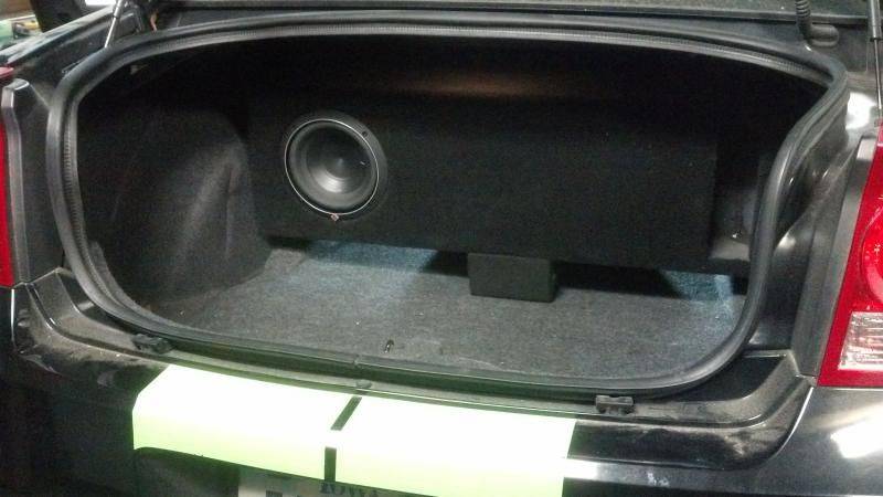

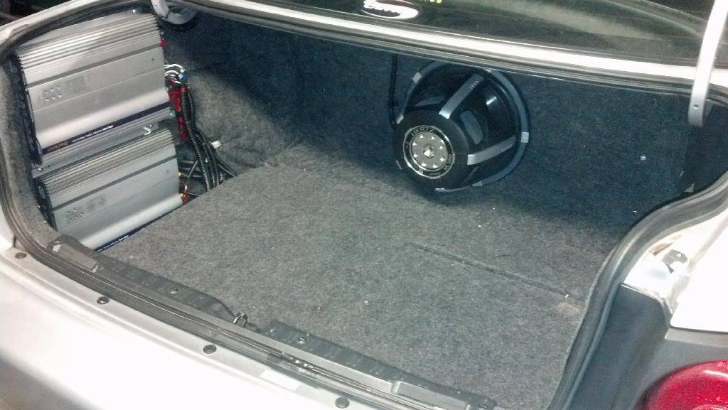

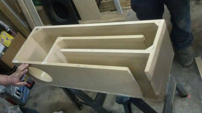

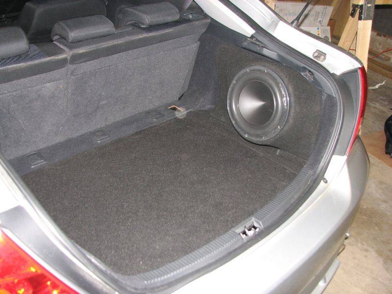

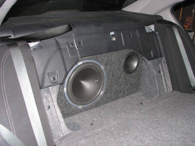

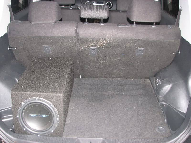

one sub is all i run and all i need. most of my installs are just a single sub - in an optimized enclosure. you can be as loud or as SQ as you want. more subs is a negative compromise unless space is unlimited.
here are examples

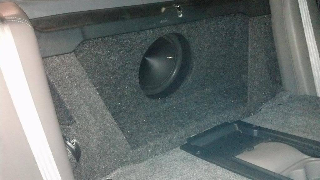

Hertz Mille 12 in a 2014 Accord
Hertz Mille 10 in a 2006 Scion tC
Image Dynamics ID10 in a vented enclosure in a 2008 Scion xB
Alpine SWR12 in an aperiodic enclosure
Hertz Mille 12 in a IB wall
Fi BL18 in a huge enclosure in an Astro Van on 2kW

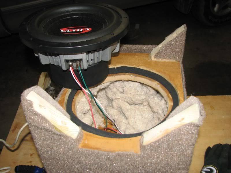

center console Ultra LV10
JL 13W7 on JL amps in a 2011 Scion tC
stick with your plan and talk to installers if the salesmen are inexperienced. you can tell the salesman you talked to that an acoustics engineer with 20+ years in mobile audio can teach a class on the merits of a single sub.
a single sub is best placed in the rear passenger corner of the vehicle, allowing for most of the storage space to be maintained while also optimizing the subs performance. corner firing minimizes phase interference.
