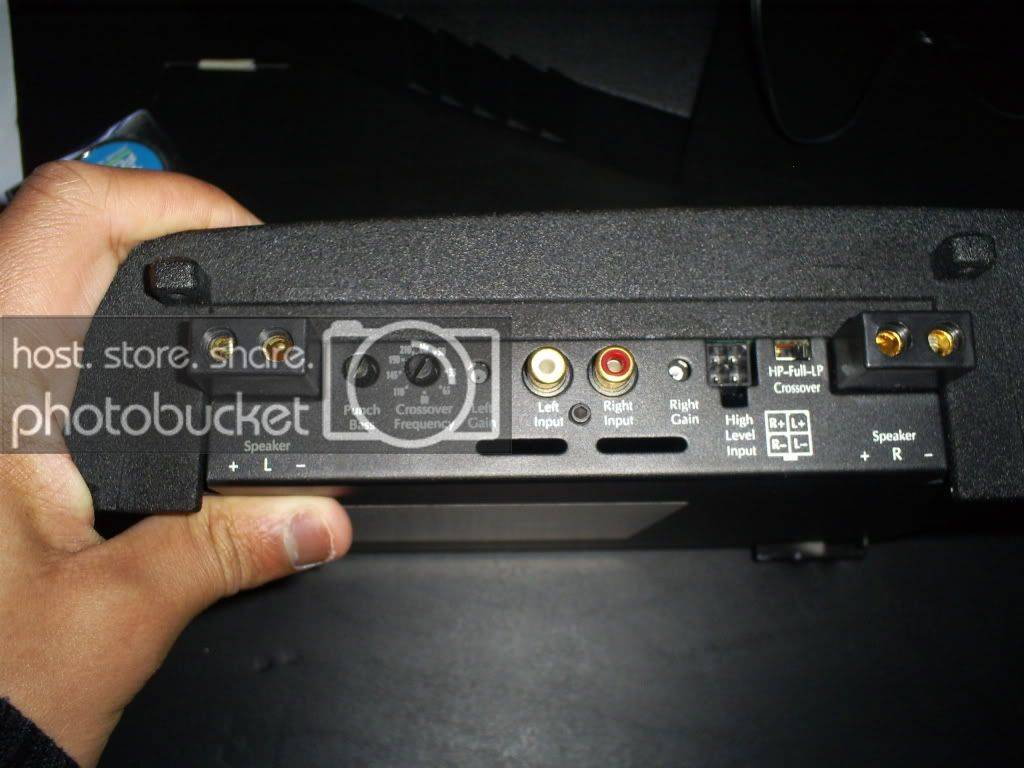

I recently got some old RF gear from my bro and i plan on settin it up in my truck, its a 2002 chevy 1500, everything is gonna be mounted under the seats. What i was wondering was how should i wire everything up? i know the amp can push 180x2 at 2 Ohms but how should i wire it so the subs can get that?
Its a RF punch 360a2 amp and Rf punch xlc 10in subs

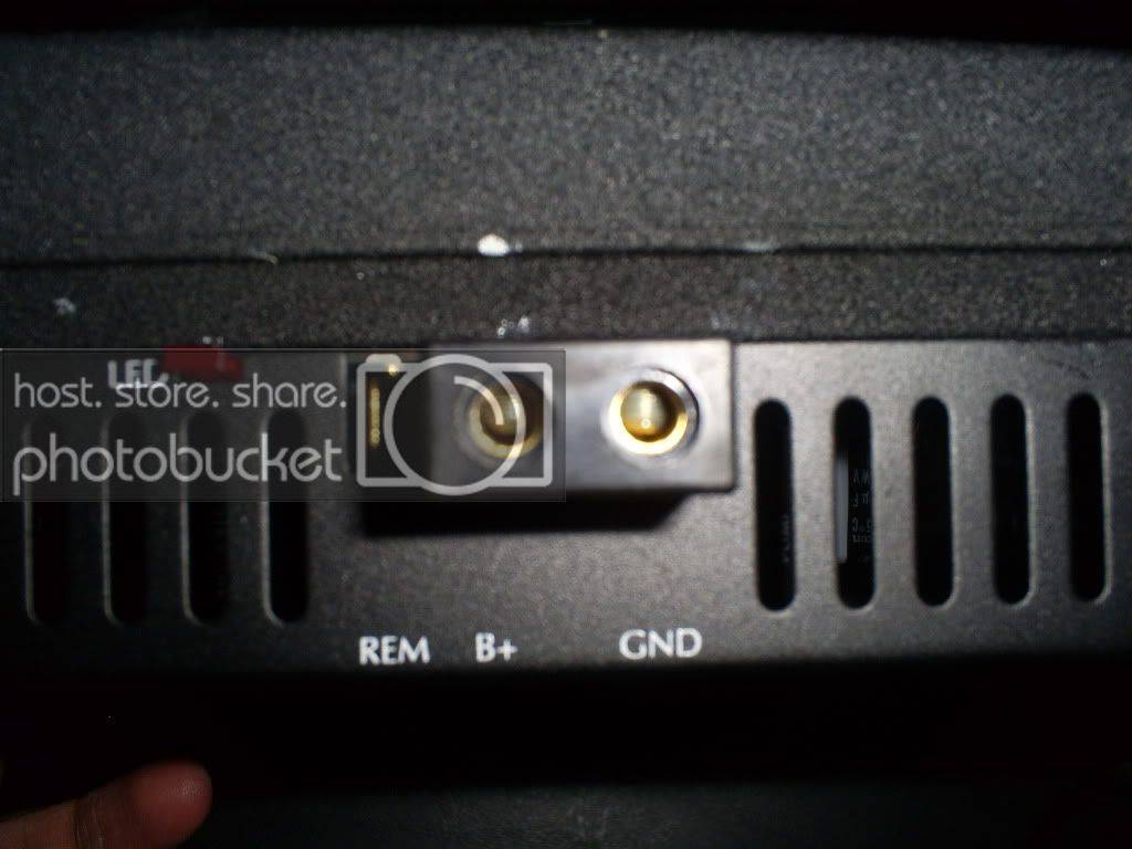

also what should the REM wire be connected too? i have a kenwood KDC-MP242 deck
Here are some pics of the stuff i have

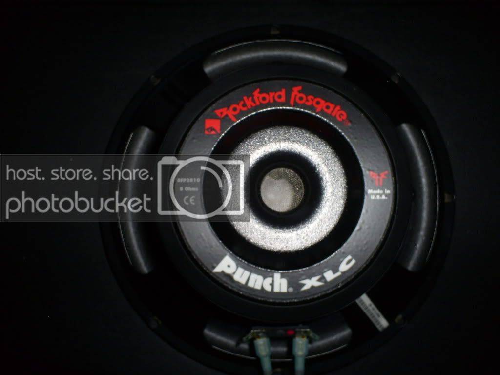

You can't. That sub you have is 8ohms = to 4ohms in parell, 16 ohms in series or 8 ohms per chennel.
If you run it bridged you would have to do a 4 ohm load, which is about 90 watts per sub on a 4 ohm load.
If you run it bridged on a 16 ohm load you would get maybe 20watts per sub?
If you run one sub you would get 45 watts on a 8 ohm load. You could run one sub per channel I guess.
Good luck

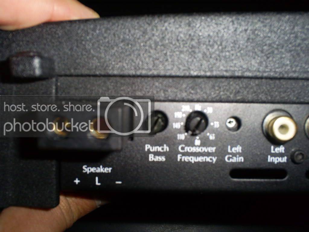

ok thanks. i'll probably run it at 90 watts at 4 Ohms. also i probably wont my crossover around 80Hz right?
and i have 2 subs both are the same
