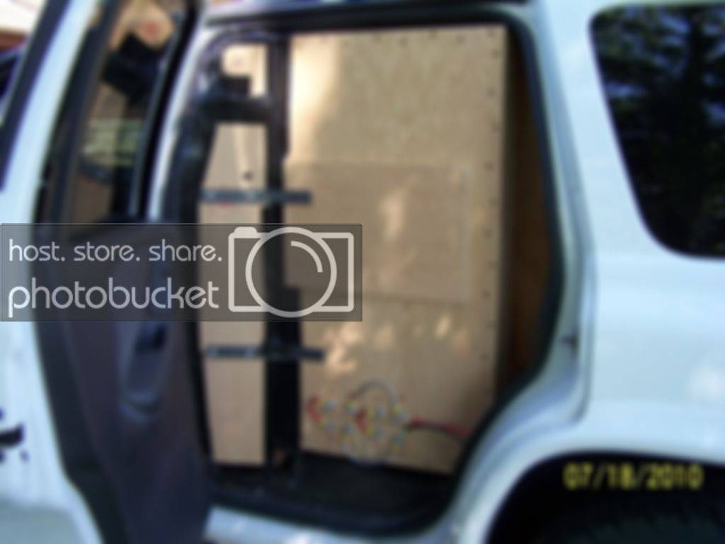

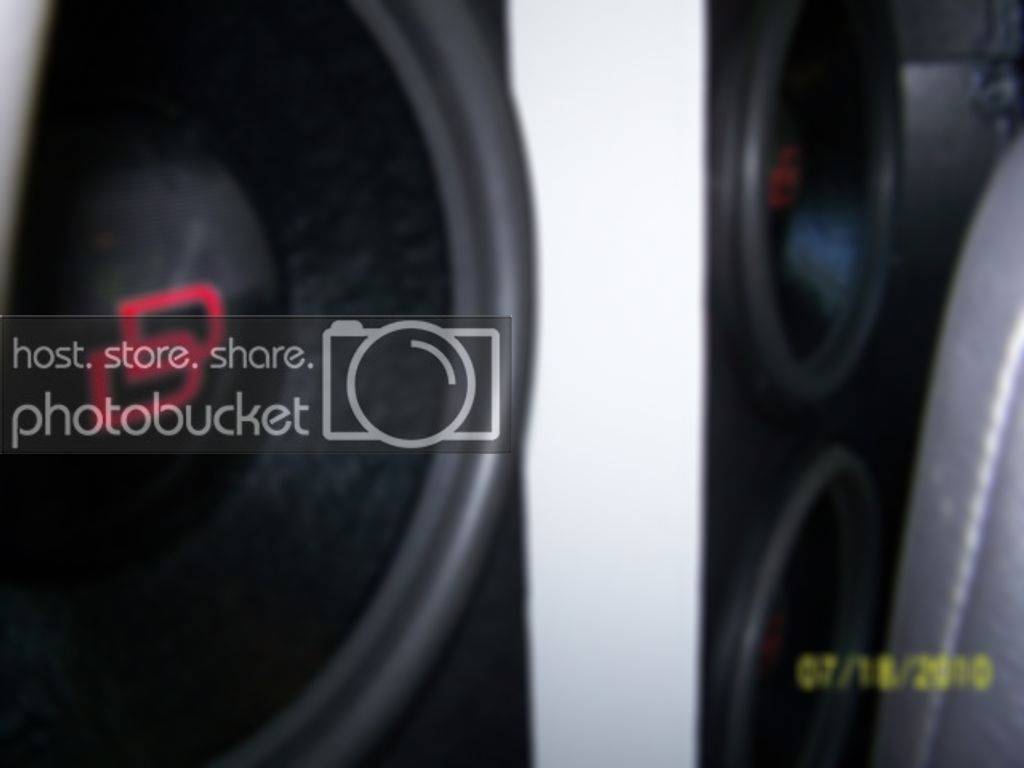

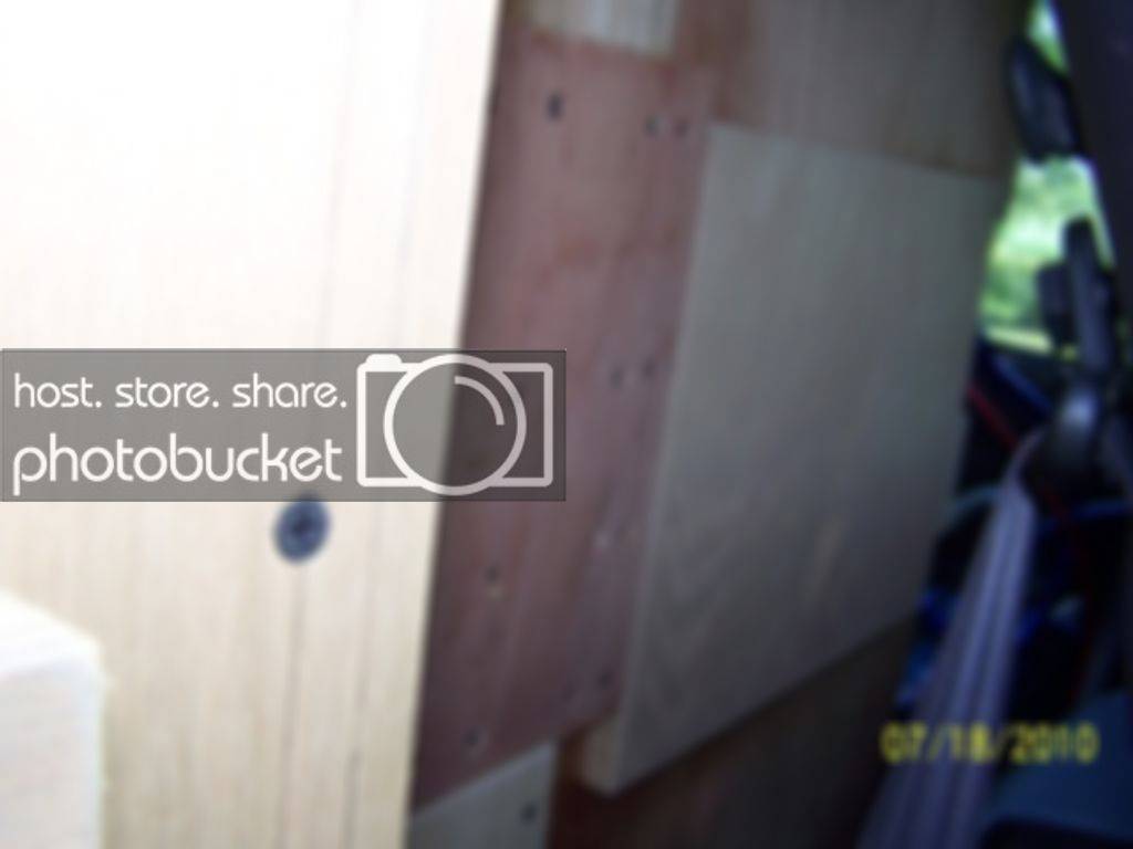

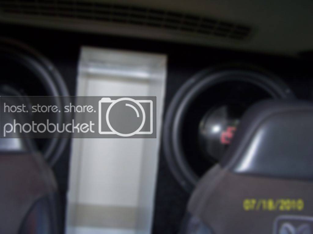

I have 4 18's in a 99 Durango.The box is walled,and it is a monster.I am running 4 DD 9518's,and only 2800 watts for the winter.Will step up the wattage to about 14k in the spring.I think it will work out better as a B pillar wall.After you see the size of the box you will probably agree.I honestly do not know if this set up will fit in a box below window line...? This box is 24 cubes net,and goes almost to the back hatch.DEFFINATELY not an easy build,nor a quick one.384 cubic inches of port.
OH,and with the batteries... I made up a box for the behind the back of the sub box,but it will only hold 6 100Ah AGM batteries.Only 44 inches to work with.Seriously no room back there.Will have to get creative to fit 8 plus the amps.
