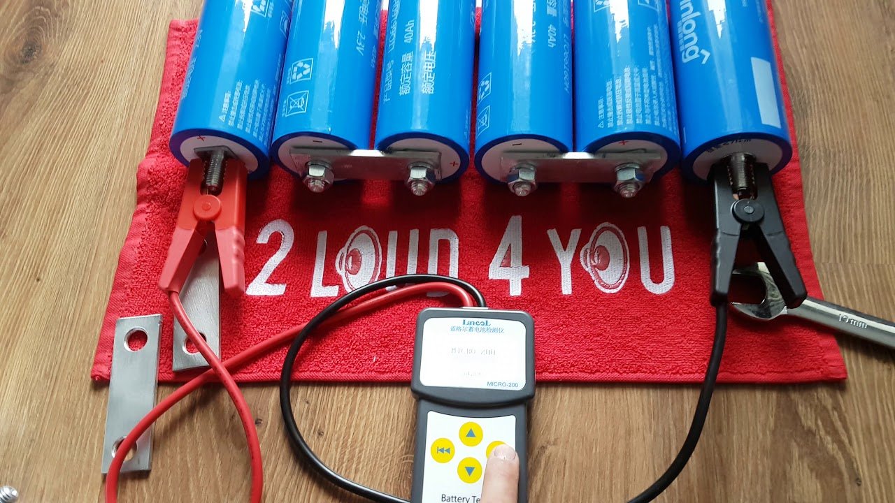

If I had to do it again I'd probably Diy 40ah of Yinlong... and it looks like it would even take up less space if done like this.
20626
Making the bars and charging/balancing the thing looks pretty easy to me and they say it'll start the car and support 4K much better than my current setup. I'm actually saving for some atm... oh well... eventually I'll have a Sms220 up for sale with bussbars, unless I chop up the bars for the Yinlong... lol
