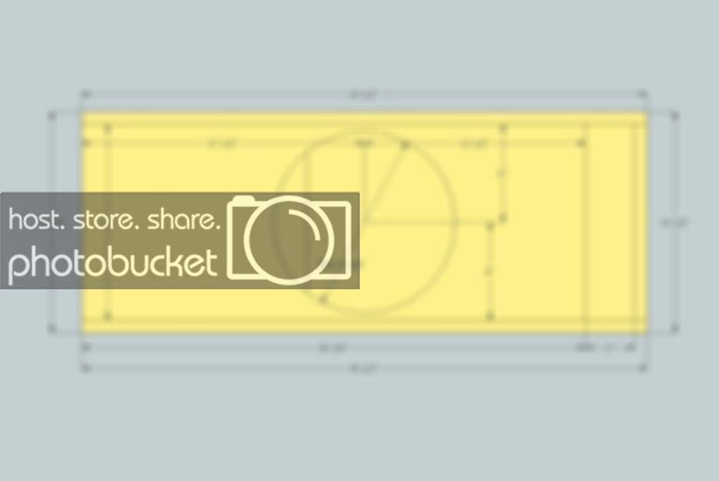

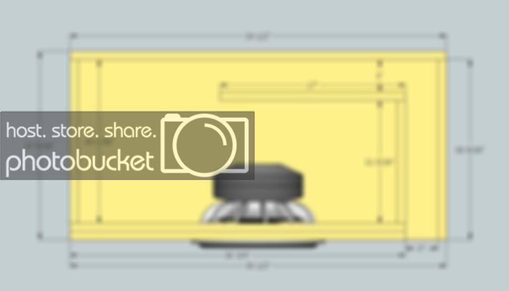

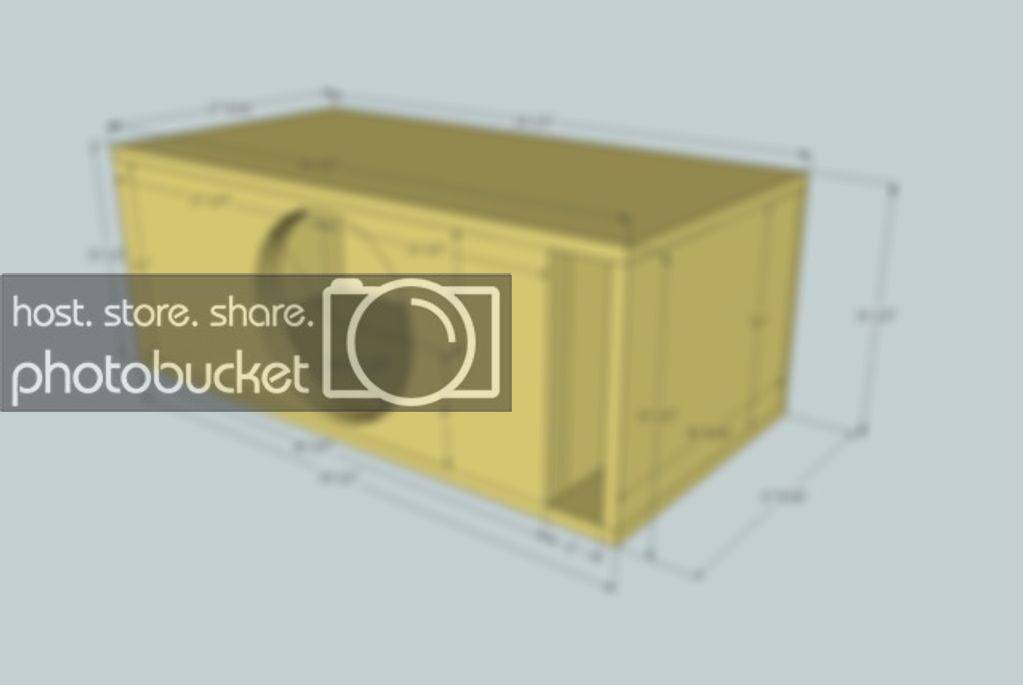

skitzafit 10+ year member AscendantAudioAtlas 857 14 IL Nov 7, 2010 #3 BL 12 2.4 cubic feet @ 32Hz BL Box cut sheets! - SSA Car Audio Forum
