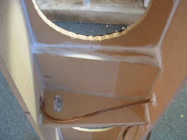

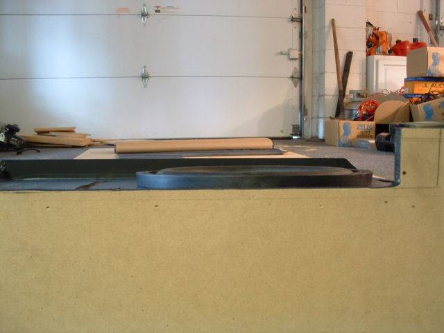

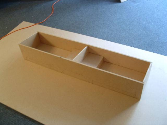

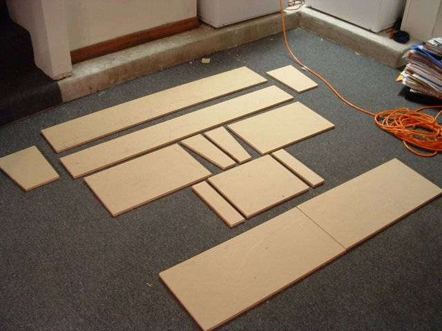

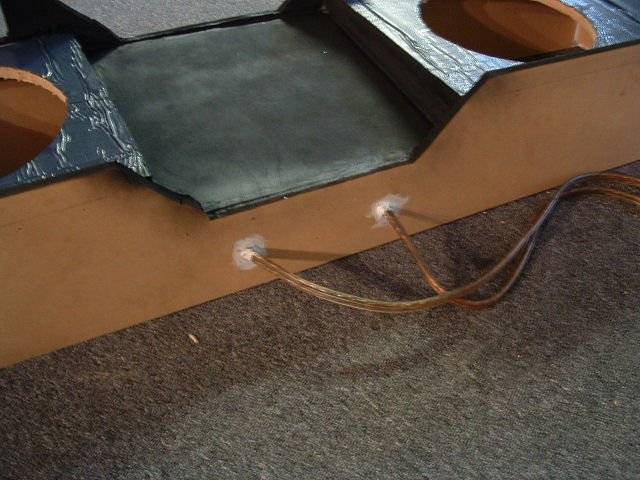

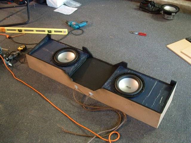

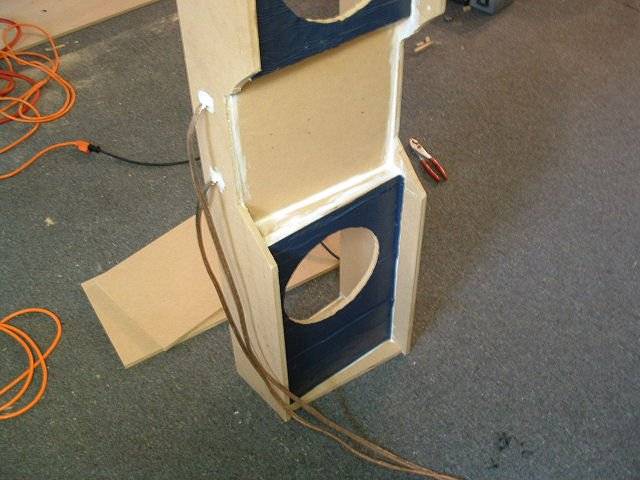

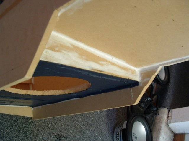

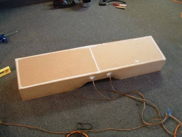

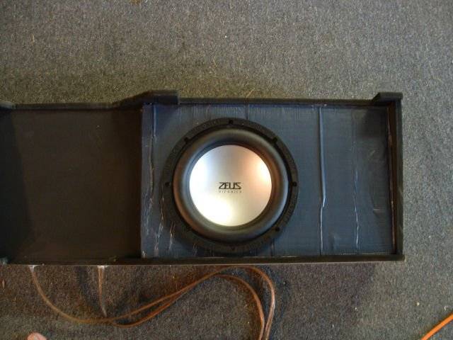

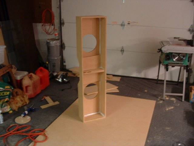

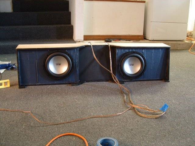

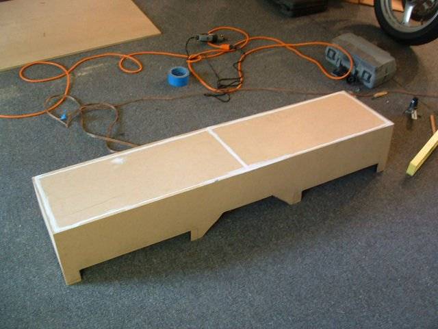

My updated 2 x 10" Sub Box / Downfiring / Angled / 1.5" to 2.5" lower clearance / .85 cu ft per sub / 2 chambers / 1/2" MDF:
lemans doesnt silicne his, he glues the shit out of them. this is a bad *** little box!
actually the pics JMAC put in that sig of lemans' boxes were not glued at all it was all caulking. He got the things to stick together with only caulking no glue. LOL
