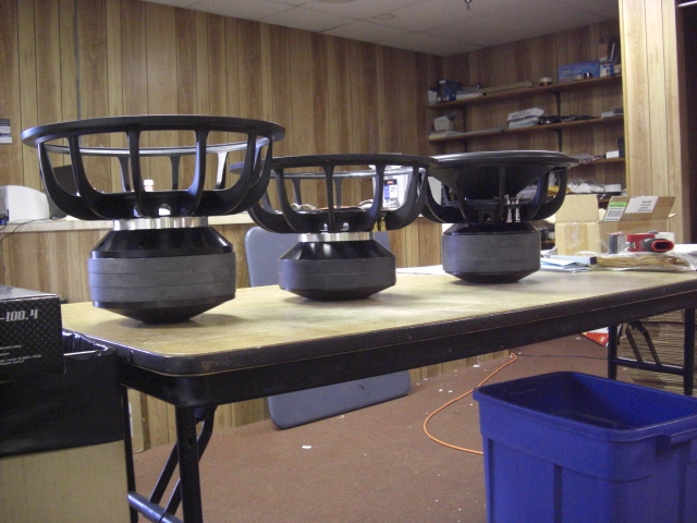

Comparison : NS v.2 / Z v.2 / NS v.1

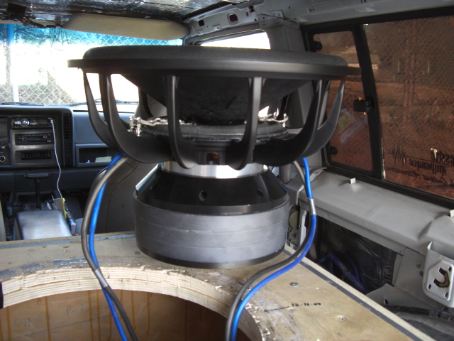

It's here ! I'll build it up once I'm done w/ shipping for the day to make sure it meets all my design specs.

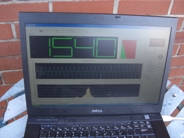

Simply comparing HU volume levels... with my HU sub control at -3 this is the results:
MONSTER : 151.6 dB
NS v.2 : 154.0 dB
The NS may be seeing way more power due to reduced inductance... I have no way to know until I find my clamp. The Monster kept getting louder until the HU hit +6 as well where it did 155.1 dB.

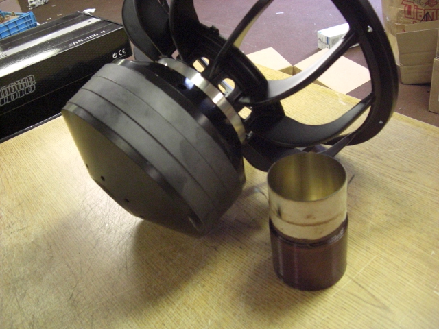

I will do more testing later... had an issue with the samples coil formers / coil leads being too short so I had to rig it up to work... one connection broke in my testing. I am ordering new coil samples with taller formers / taller coil leads for production and further testing. I will try to rig it up a better way to get more testing until then, though!

But in all seriousness, that is one good looking motor! For people wondering what a space ship would look like coupled to a 12 spoke frame, look no further. //content.invisioncic.com/y282845/emoticons/biggrin.gif.d71a5d36fcbab170f2364c9f2e3946cb.gif

I'm using two 4500D prototypes at 1/4 ohm each... HU at -3 sub control.
With the Monster I kept getting louder up to +6 on the HU... but without my power clamp I don't really know how much more I have to go.
