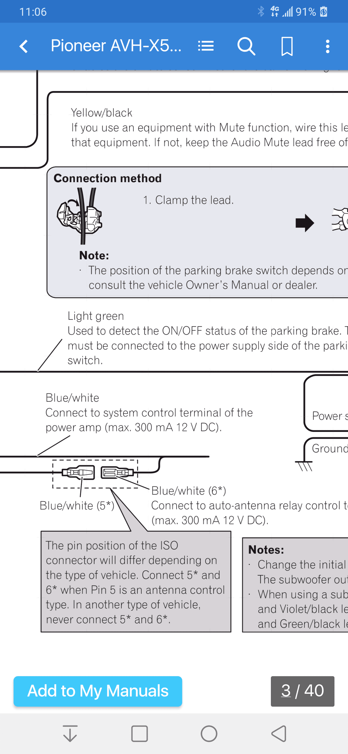

When I installed the system I used a PAC harness system to retain the factory Bose amp so the Nissan harnesses plugged into the PAC and the on the other end the harness hardwired to the radio harness. I matched all speaker wires correctly, red power wire to red for ignition, black ground to black ground wire (not to metal surface), yellow to yellow for battery. But the blue/white wire on the PAC end and a blue wire on the PAC end to the blue/white wire on the radio harness. Radio harness has no blue. So these three connected. I am not sure if that last part was correct but I’ve researched that it can be hooked up this way. I have also wired in a micro-bypass.
The radio should have an antenna trigger as well. By connecting the amp trigger to it, it may be messing with the signal.
Yeah, my AVH2500 NEX doesn’t have a blue wire antenna trigger on its harness. Only a blue/white. While the PAC side has the blue wire and a blue/white.
What should be done in this case? If I disconnect the blue wire, what will power the antenna?
