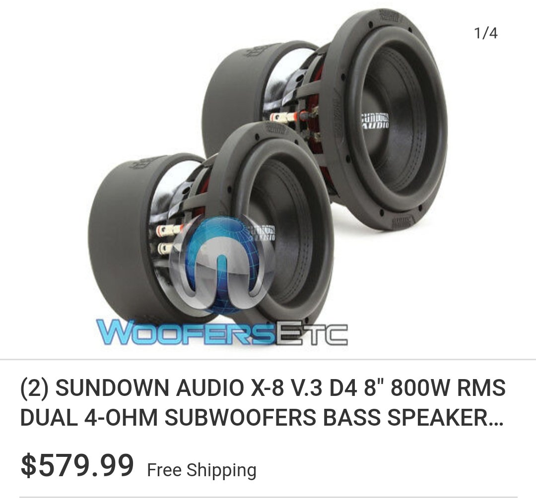

If you go with 4-8's, then, you should look at the Sundown SA-8 or the AB VFL8. Those JL's are so overpriced.
You could get four of these for half the price of the JL's.
