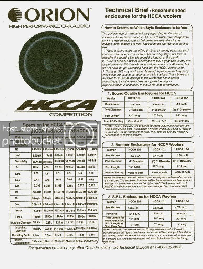

Here is the spec sheet, looking at the 12D.

The specs say 1200w pmax, but I have no idea what the RMS is =/
is it a good rule of thumb to just half it? (i've checked everywhere online)
