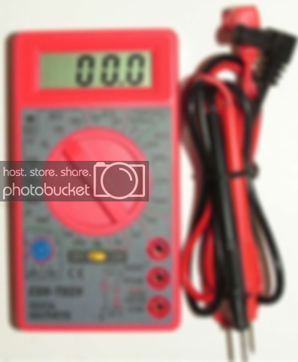

this tool is going to be your new best friend.
use it everywhere there are electrical wires in your car.
test voltage and or ohm rating at the begining and end of every wire you can find.
your car is 1973? I had a 72 pontiac lemans - and time does wonders on old cars.
I had to replace about 1/3 of all electrical wires in my car, due to the actual wires getting tore up and being terrible at conducting electricity.
