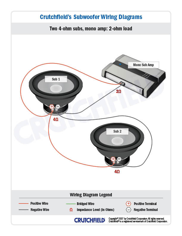

now, that will give you 2 single voice coil 4 ohm subs...wired like this
so you need an amp that will give you 400watts at 2ohms....give me a few minutes and let me do some looking around and I'll see what I can find...

ohms is hard to explain, In fact...I cant...I always use the Crutchifield Subwoofer Wiring Advisor
as long as you know how many voice coils the sub has, and how many ohms each voice coil is, you can use Crutchfield to show you the ways to wire them up
for instance, my subs are Dual 4ohm Voice Coils..
so if I use both then I can only wire them to either 4ohms or 1ohm, depending on how they are wired
but , like I said, supposing you get another MTX ...they are both Singe 4ohm Voice Coil subs and so will be only able to be wired to 2ohms.
again, I dont really understand how it works, I just use Crutchfield and wire them like it shows.
