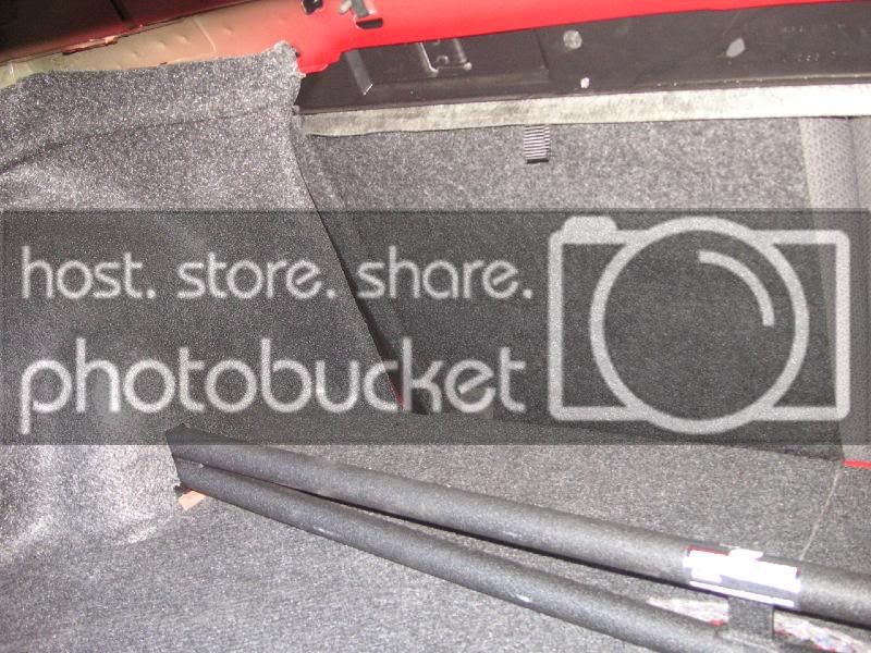

OK I'm going with either a 10/12" RE SE or a 10/12" OZ Audio ME. Both need about .75-1ft^3 sealed. If I went sealed, I think I could fit it behind my shock tower, which is what I want. Dimensions would be 14x20x10 with 3/4" MDF (that's if I could fit a rectangular box in, but with the seat angle these aren't accurate dimensions). This would work with either one, but I would rather do a ported box. Not sure if I can fit one in this space. Here are some pics:

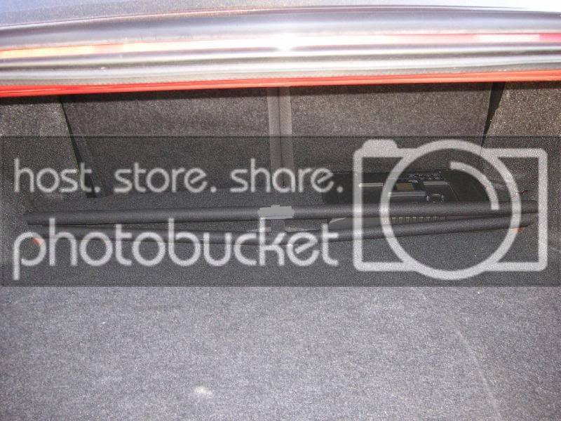

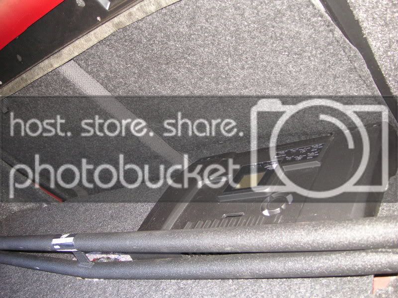

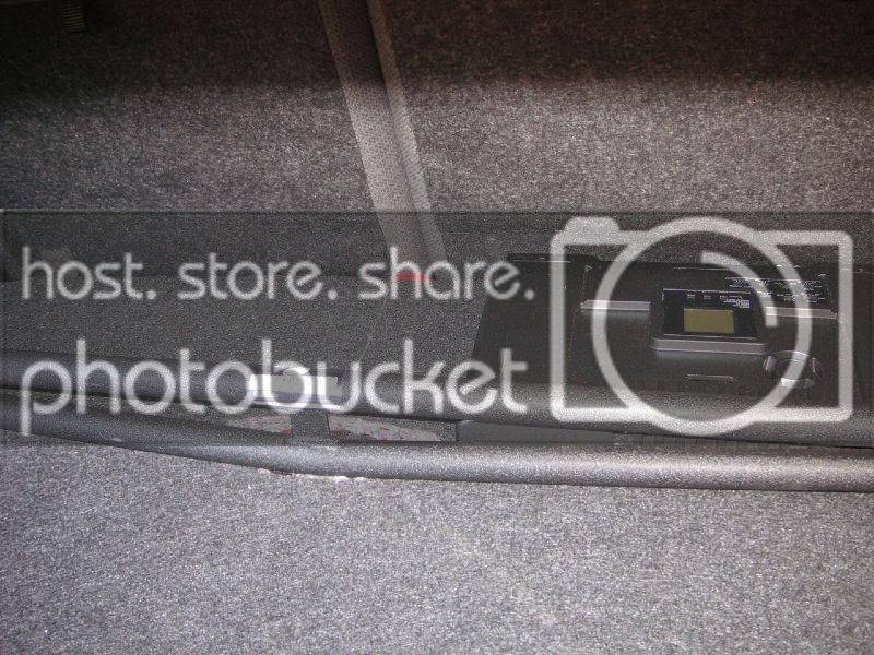

Problem is, the trunk narrows at the sides. You can see the point with the most depth from the rear seat is the very center, right where the edge of the current amp sits.

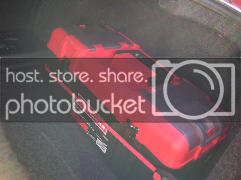

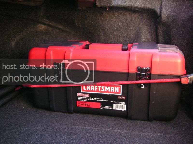

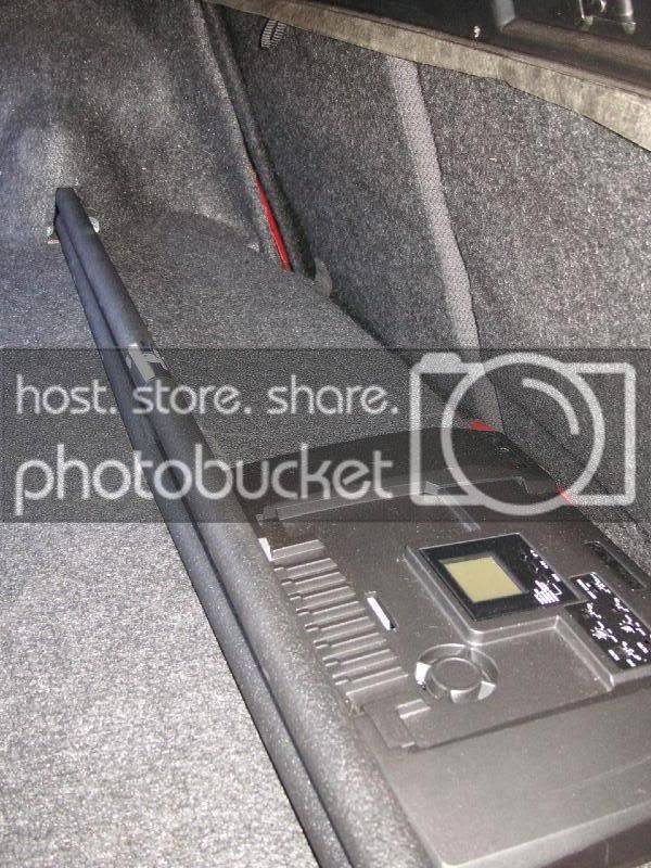

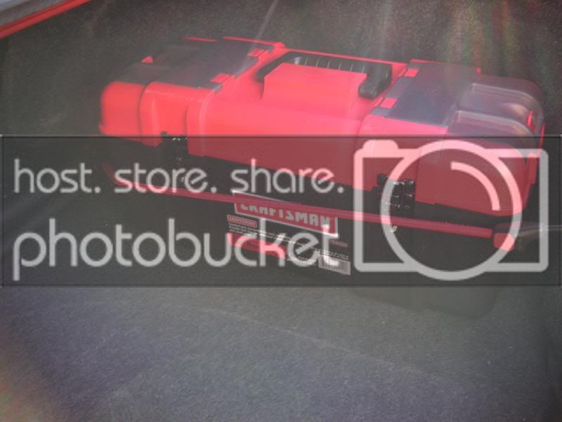

I would theoretically like to build an amp rack for my US Amps AX 5600 and put it off to one side and the sub on the other. If I won't be able to fit either of these subs, I may do a pair of 8s. OR...I'm thinking I can mount an enclosure off to the side in the right corner, where my current toolbox is here:
Only thing with this (even though it give me WAY more options for sub size and enclosure size), is that I like everything to be flushed in. I would want to make a beauty panel to cover the box and the rest of the space behind it. Then make an amp rack for the amp, where the current one is, on a false floor that is only the height of the rear brace. Then mount the amp right in the middle, wires all hidden. I know this is a HELL of a long post. So thanks for looking and advice if given.

Not quite sure what you're looking for, but i'll list some stuff i'd do if I wanted the box to go next to where the amp is currently mounted/sitting. Steps are not going to be written specifically as you make the box vs someone else, but you'll be able to understand what i'm saying.
1. take a BUNCH of measurements, with diagrams so you can decypher WTF you are looking at later. I would start with the area the amp is in, behind that bar. I'm assuming that it's stationary? I would get the depth at the floor going across, the height, the angle of the seats, ect. The more measurements, the easier to figure out what to do. Once you think you have enough, take more. Been there with projects like that, always regretted not having that last dimension.
2. You could gain some volume by making an upside down U into the box setup to go over the bar, that way it could extend out a little more. Could even do some fiberglass work, and use a PVC pipe as the part that goes over the hump.
3. Sealed it'll be not bad once you have all this. Don't know the specs on the subs, but IMO ported wouldn't be bad either. I am NO box builder/designer, but it it would work, i'd go with a 4" aero port or two, exiting on the side of the box, above the amp's current location. I am assuming you want the keep the amp in that general area, and use the other half of that area for the box?
4. If you do the ports like I said, you could incorporate a 90* elbow to change the direction it points. Again, i'm not designer, dont' know jack whether this would work, tuning wise and such. I'm picturing the aero sticking out of the box.
5. I didn't take into account any beauty panel type setup, or a real amp rack type thing. I don't know how much they come into play when porting, ect.
