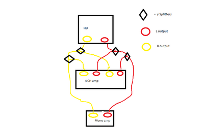

Pretty new to car audio and trying to learn as I go.  Trying to figure out how to wire up 1 4 ch amp and 1 mono amp.  The 4 ch will run 4 speakers (1 speaker for each channel) and the mono will run my two subs. My head unit only has 1 set of RCA outputs and my 4 ch amp only has 2 sets of RCA inputs (1 for front, 1 for rear) and no RCA outputs on that amp.  My mono has 1 set of RCA inputs.  How would I go about wiring 1 set of RCA from my HU to make 3 sets of RCA for both amps (2 sets for 4 ch amp, 1 set for mono amp).  Is it as simple as using 4 y splitters?  I've attached a very "artistic" drawing I made to better describe what I'm trying to do.  Is this not an acceptable way to do this?  is there a better alternative?  I appreciate any help you guys could give me.
Thanks
