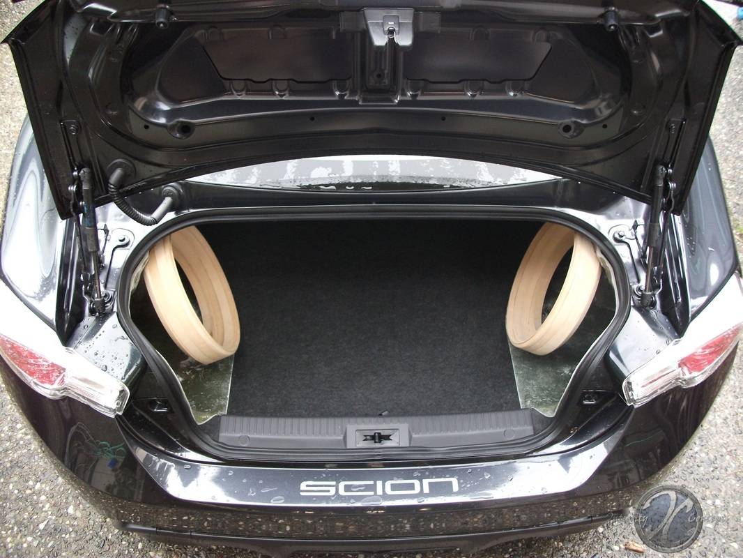

Nah you can build up MDF rings pretty tall. Wont have an impact on SQ. Just make sure they're glued down good to the sub cutout. Can you post a pic of your box?
Here are some built up MDF rings.
