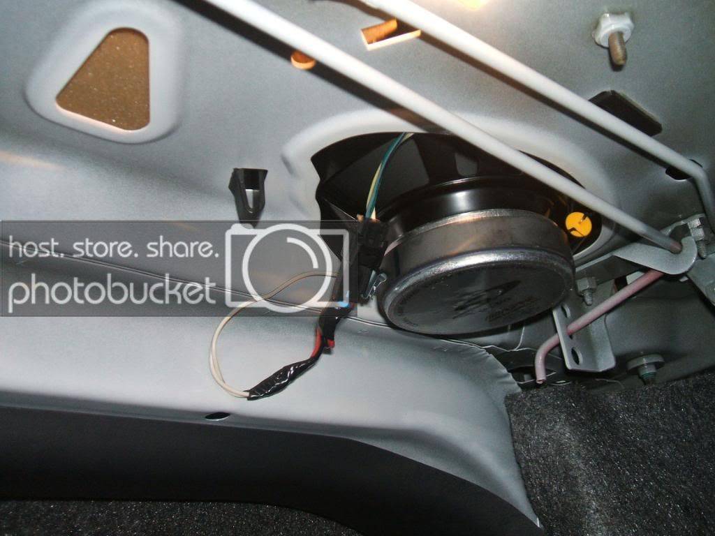

Here is a picture of a guy that has it done....It is not mine.
