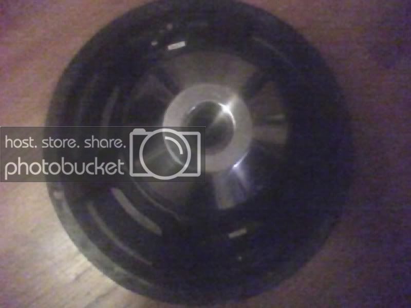

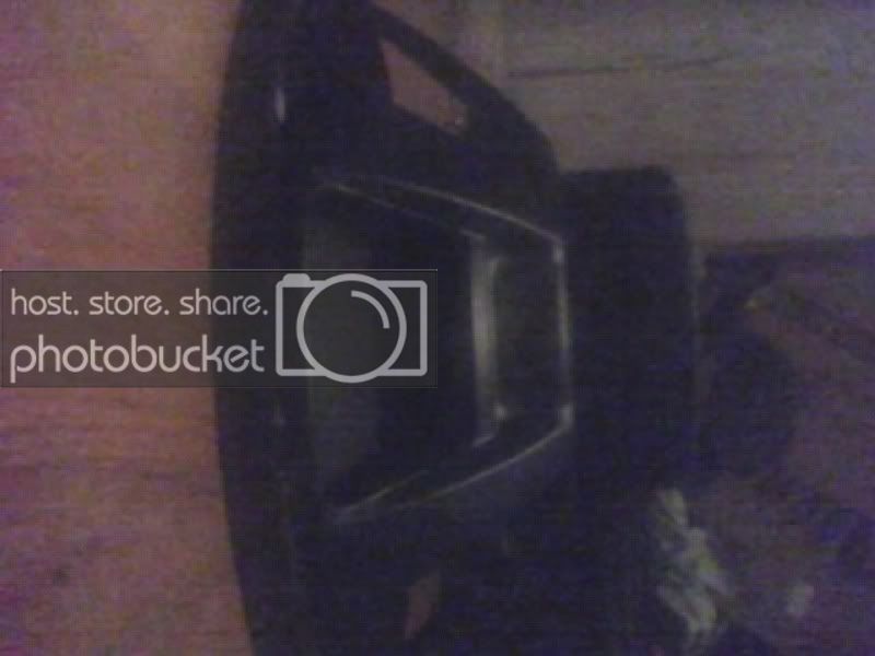

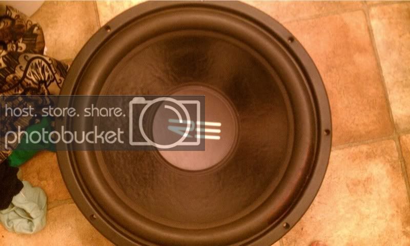

This is what I got and I don't know what it handles or what model it is all I know is it is a dual 2 ohm.
I don't recall the SE ever using this basket, though. I'm thinking it might be an RE recone or something.
Having some type of pic that allows me to see the size of the motor would probably help a bunch...
Well remember that this year that they changed the basket designs on the SR, SE, and SX models. And looking at the pole vent again, I am saying SXX with the shitty motor boot taken off.

I'm in total agreement that it's one of the new RE X subs. I just don't know which of them uses that particular dustcap. The motor looks pretty small for it to be an SXX, but I haven't seen one of the newer ones in person.
It's definitely a RE X sub, but I don't know which...

Yeah it does look small, so maybe it's the SRX? The pole vent is too small for the ***. And that would make sense with the dustcap too since I think the *** and SXX both have the cap that covers the entire cone.

I can agree with that.
OP, if it is indded the SRX, and I'm thinking it is, here are the specs.
Mounting Depth - 7.9"
Mounting Hole Diameter - 14"
Overall Diameter - 15.6"
Bolt Hole Circle - 14.7"
Motor Width - 6.7"
Motor Depth - 3"
Basket Depth - 4.9"
Displacement - 0.16 cu. ft.
Weight - 16.5 lbs
Electrical Q Value -Qes: 0.45
Mechanical Q Value -Qms: 4.87
Total Speaker Q Value -Qts: 0.41
Free Air Resonance -Fs: 23 Hz
Equivalent Compliance -Vas: 203 liters
One-Way, Linear Excursion -Xmax: 18 mm
Efficiency -SPL 1W/1m: 87.6 dB SPL
Effective Piston Area -Sd: 810 cm^2
DC Resistance -Re: 1.8 ohm
Nominal Impedance -Znom: Dual 2/4 ohm
Thermal Power Handling -Pe: 300 W
Force Factor -Bl: 14.35
Enclosure recommendations:
Sealed - 1.5 - 2 cubes after woofer dispacement
Ported - 2.5 - 3 cubes after woofer and port discplacement (tune to 34 - 35Hz)
