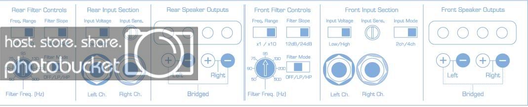

With my passive crossovers always cutting off at volumes it shouldnt, i believe i have no choice but to go active. Ive read up on an thread here about active vs passive and it says something that is needed.... lots of time to tune. Unfortunately, i work 10-15 hours a day and really dont have energy to do all this. Basically i need help setting it up towards where i wont blow my speakers when i first start using them. Here are my specs
JL 300/4
2 way Rainbow Pro fi Kickbass
Alpine 9855
The amp
Speakers specs (off manual)
Frequency response 80-25.000 Hz
Slope 2 x 18 db octave
Crossover Freq 2.400 Hz
The 9855 has a built in crossover as well that i really never messed with because i never really understood how it works.
My questions are
- When going passive, is it okay to use a y connector to split a 2 channel connection from the HU to 4 channels to the amp or should i do 2 runs of RCA connectors from the HU (one set of rcas as "front" and one as "rear" from HU) to the amp?
- How do i set this up towards where speakers dont blow when i first start using them?
- what settings should i set on the amp (look at pic above). Im going to already assume all of it is going to be bypassed to High or at least the tweeters will be.
- What crossover settings should i set on the HU?
All i want is a safe side to do things for now and still sound very good, after understanding this all more and having more time ill tune it to how i want it to sound.
Thanks
the 9855 has a built in 3 way xover. whenever you got time, read the manual. i'm sure its you have to get in pro/advanced mode of some sorts.
then in 3 way xover mode, you can high pass the tweets and bandpass your mids and also low pass your sub. then just turn off the xovers on your amp and you have complete control over the xover pts and slopes through your HU.

Use the 9855 to control everything and turn all the filters on the amp to pass (ie not on). Then set it up like this:
Front (tweeters): HP at 2.5kHz
Rear: (midbass): HP at 80Hz and LP at 2.5kHz
Nonfader (sub): LP at 80Hz
These are just general starting points. You will have to adjust the frequency and slope to whatever sounds best to you. Maybe start with 24dB/oct slopes at all the above points and then adjust accordingly. You have be carefull that you don't run a full range signal to your tweeters. They will not instantly blow or anything, but if you drive them for a while without noticing, then there will be problems. It would be best to set all the x-overs on the deck before you plug the speaker wires in- just for safe measure anyway.

Anyhow going active USE the 9855, dont bother with the JL built in xovers they cant bandpass your mid.
