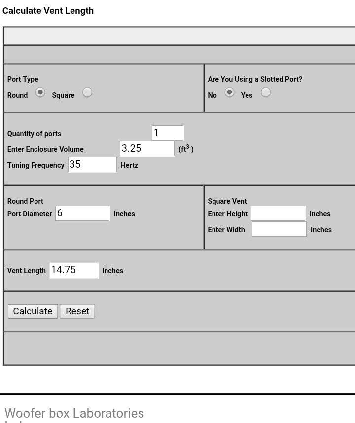

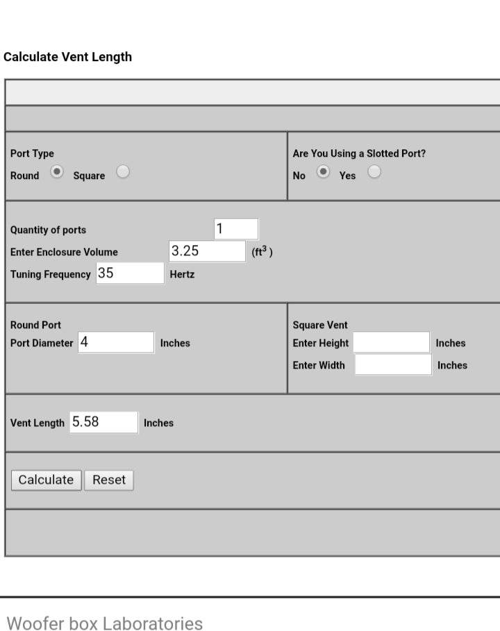

I calculated  for a  3.25cbft box after port and woofer displacement with One single round port 4 inches in  diameter x 5.58" in length to achieve 35hz tuning. Or one 6" Inch port at 14.75" long.
Can anyone very this with your method of calculating ? The  Port length seems like it would be shorter for a 6" diameter port and need to be longer for a 4 inch port.  Unless I'm wrong.
52 sq" is the total port area. The larger the diameter the longer the port will need to be to achieve the same tune as a smaller diameter. There are companies that give suggested round port size and length at their suggested box volume.Personally I rely on software programs like bass box pro or winisd when deciding on what diameter/ length round port to use. You didn't mention what subs or what amp you're going to be using? 4 10s in 3.25 net? Idk seems awfully small to me anyway.
:iagree: ... good advice... using just a calculator is not going to be very accurate. The results you get from using a calculator are only as good as the info you input from modeling
4 soundqubed hds2.110 subs
4k amp , it is 3.25cbft after all neccessary displacement for 4 of these particular woofers regardless of  box design.
I did rely on a somewhat reputable port size calculator that bases port size on cbft number of ports and desired tune/hz.
