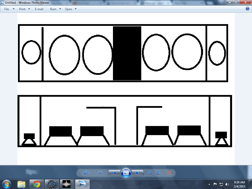

I am planning on 2 6" speakers on the ends and 4 10" subs in the center.*
I will be running a 2 channel amp for the subs.* Will the box need to be ported or is sealed better?* Does each sub need to be sealed or can 2 go on one side and 2 on the other?*

subwoofers and speakers need to be separate chambers or else you'll end up with a lot of cancellation(google speaker cancellation if you dont know)
You have space for 4 ported 10" subwoofers and around 0.4-0.5 cubic feet sealed for each 6.5 speaker.
marine grade ply would be fine but i would still get the edges covered up with something for longevity reasons.
scrap your ported design. It will actually look like your sealed box with two 10s on each side and a single big port right in the middle of both.

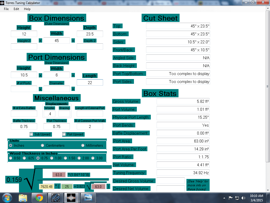

Then plug the sub's parameters in this software and then plug the box specs in and see what kind of sound you will get, spl possibilities, port noise/rear air velocity etc...

also for the port design, lets say for example that big port in the middle is 7 inches wide, and when it starts to bend, since it splits up, each side will be 3.5 inches wide afterwards.
For the software, you'll want at least 1 cubic feet for each sub with 12 to 16 port area per cubic feet. Be sure to include common port walls and displacement of the subs which is .1 cubic feet per subwoofer. The tutorial for torres is on the download page which will show you what common port walls are.
Port length is not how long the wall needs to be, its a measurment straight down the middle of the port. for example its the red lines in the box designs on this page http://www.srtforums.com/forums/f40/official-free-ported-box-plans-56k-no-435910/ Use that to figure out how to do a proper port length.
Example of a design after I take away 15 inches for both side 6.5 speakers.

That screen shot helps out a lot, thanks!
