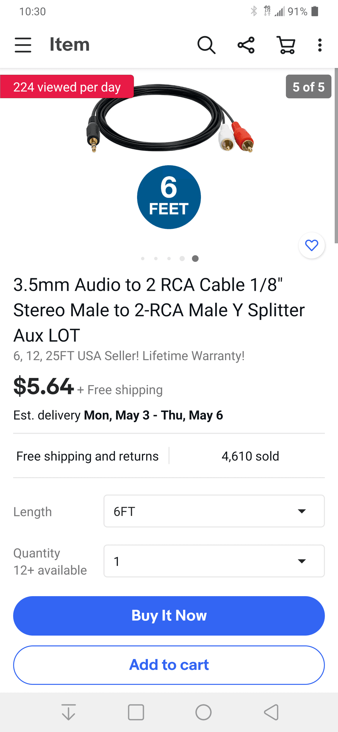

Connect an 3.5mm to RCA wire from your phone to the amp. Turn down gain/sensitivity to 2v. Play phone on half volume. Turn on amp . Turn up gain/sens. If it does not play, amp or subs are the issue. We'll pick it up from here after your testing. Good luck.
Should be available at Autozone, Walmart, Bestbuy.....
