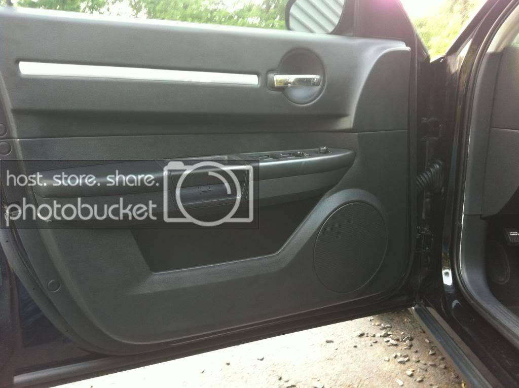

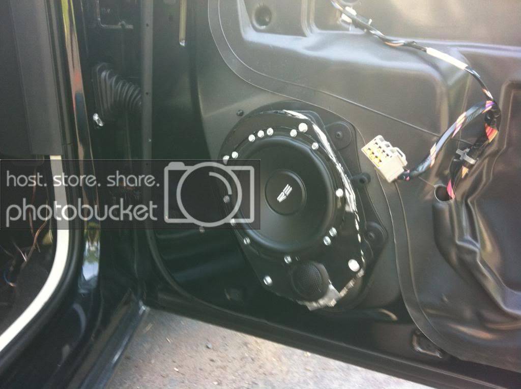

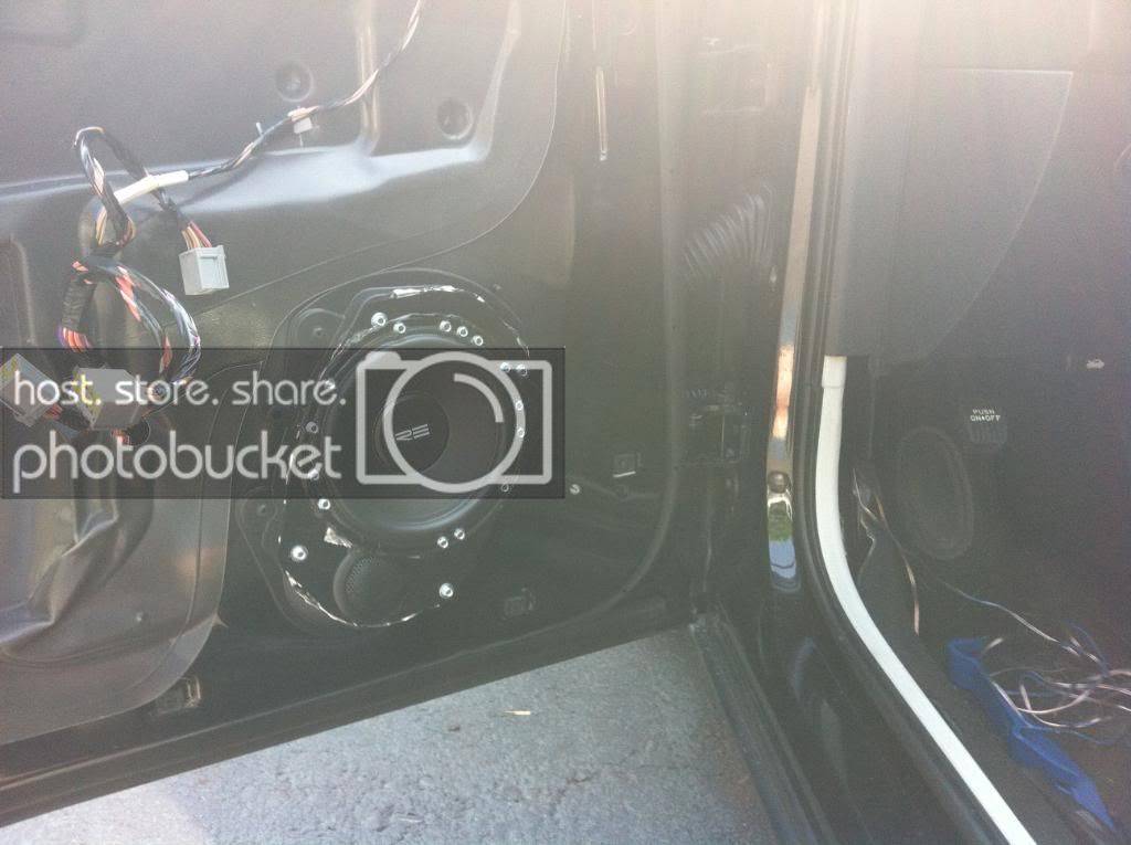

Components installed in the doors. The silver is dynomat, I always use it between speakers and baffles. Used adapter brackets to mount the 6.5" and tweeter in the factory 6x9 opening, but I had to mod the adapters on the grinder quite a bit, the holes were not big enough for these speakers. lol.
The door looks completely stock with the panel back on.

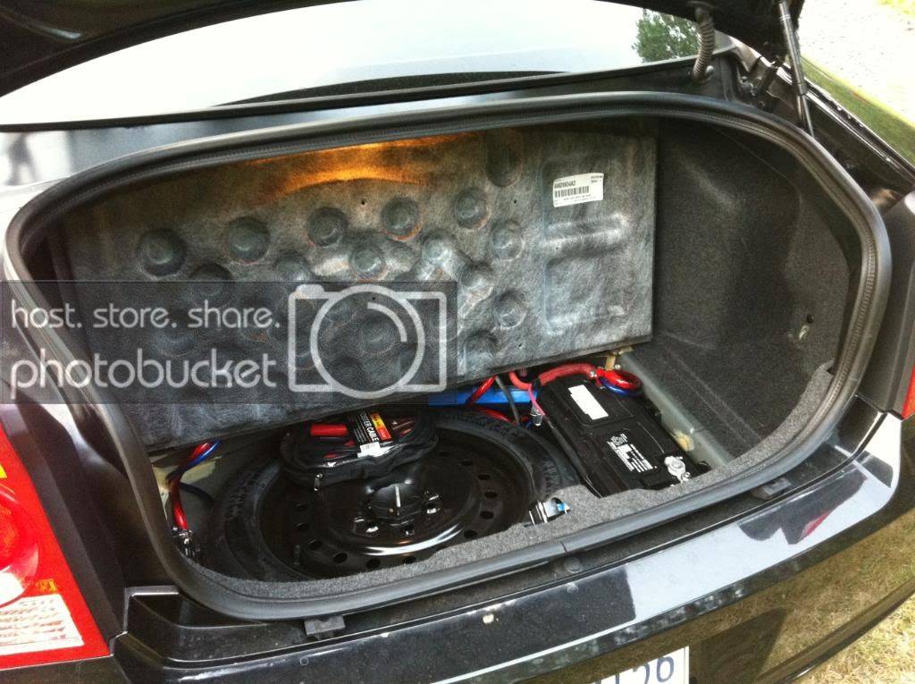

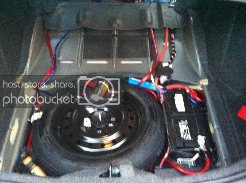

View of the battery / spare tire compartment with the trunk liner still out, fuse blocks mounted on the left.

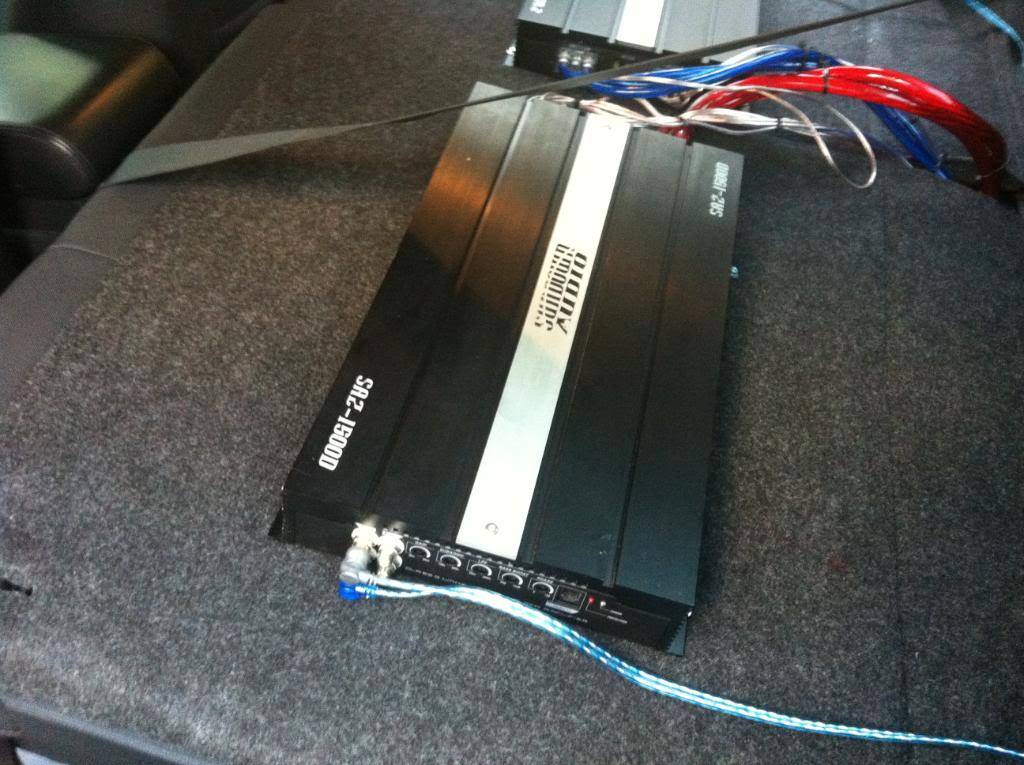

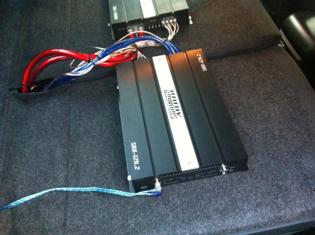

Amps on the back of the seats.

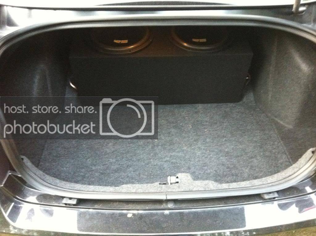

I bought 4 subs since they were a deal at $100 each, and I was impressed by how loud it was... actually was WAY more bass than I need lol. So I took 2 of them out and sold em to a friend, so now I'm only running two of them at a 2 ohm final load to the 1500D, so getting ~800 watts. And it's still plenty loud.
http://i518.photobucket.com/albums/u347/nd4spd18/Charger/IMG_0046.jpg
And this way, the spare tire compartment is easilly accessible since the box doesn't sit on where it folds up. And I half half my trunk left.
The split rear seat can still have half folded down.

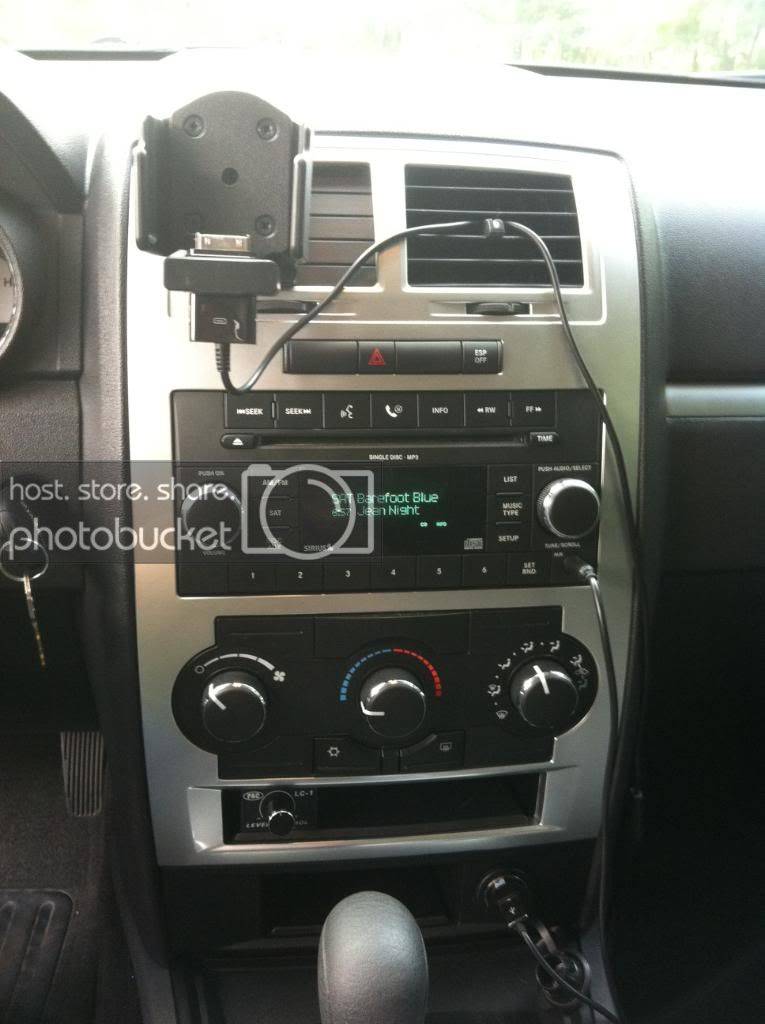

I used a PAC audio interface to get RCA outs from the factory radio. Here you can see the radio with my iphone mount, and PAC audio bass level control.
