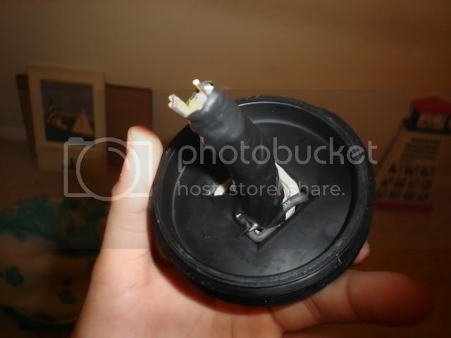

i went to home depot today and got all the stuff. i shot it only twice tonight b.c my dad was getting mad but yea this thing is badass no joke. barrel is like 3'6" long and the whole thing is about 5'8" tall. it wasnt too hard to make but its a killer how u have to buy full 10' pieces of pipe at HD. it came to about $44 after tax and i still have a shit load of pipe left over to make another two or just one with a really long barrel i dont know yet. anyways here are the pics

Thats ABS plastic or black painted PVC?
If it's ABS, good choice. I don't think duct tape is entirely necessary, ABS pipe is used in firework mortar launch tubes because it fails in a less dangerous manner than PVC under pressure. PVC blows up sending shards everywhere, think shrapnel.
