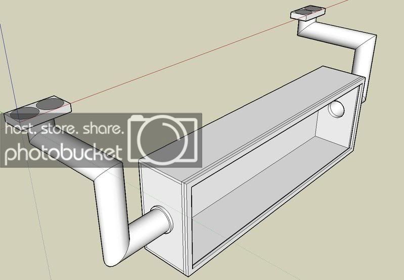

I want to use some fans for some exhaust/intake to cool my amps.
So, I want to create a completely separate enclosure for my amps, maybe have a plexi face, with some LED's or something, not sure. Might make it look snazy, might just cover it in carpet and call it a day. I want to put 1 or 2 intake fans (Either 60, 90, or 120mm fans) on my rear shelf, funneled into PVC pipe that goes to the enclosure with the amps, then the exhaust will be the same, with 2 exhaust fans shooting through my rear shelf.
Wire the fans to an ignition source on my fuse box so they'll run when my car's on so my amps don't overheat.
Aye or nay, good sirs?

Here's a quick SketchUp... not to scale. The PVC reaching back will probably be longer.
And I'll probably make some sort of shoot for the Fans, so it's not so... boxy.

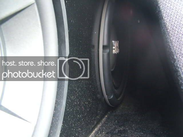

The subs will not be sealed in the trunk. They will be firing into the cab VIA a hole in the rear. Here's a picture of my current set-up:
(this is the only picture I have)
As you can see, they're behind the seats, but firing into the cabin.
It will continue to do this, except the trunk will be sealed off. The subs will be in the cabin, as will the port.
The only thing I'm doing is not allowing the trunk to pressurize when the cabin does.
Like I said, less air space = more pressure. That's why a lot of trucks can get loud with less.
Or at least that's my understanding.
