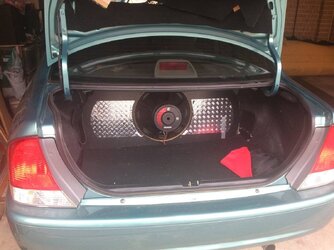

Currently my ride has dual Alpine Bassline SWA12S4 in a 15 cubic feet air space and I am happy with the result and I am feeding them over 400rms per driver, since the box makes them very efficient, I don't have to drive them too hard for them to go loud.  Best thing about IB is that you feel the bass at lower frequencies rather then just hearing them. :graduate:   I reckon once you go IB, you will never go back to a boxed woofer again! :fro:
