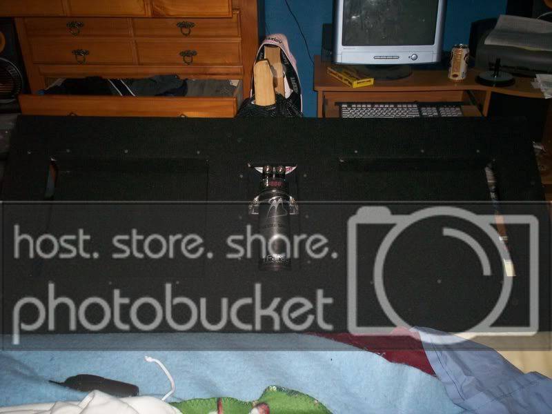

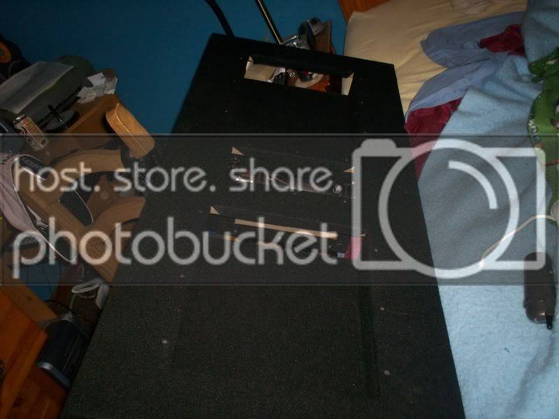

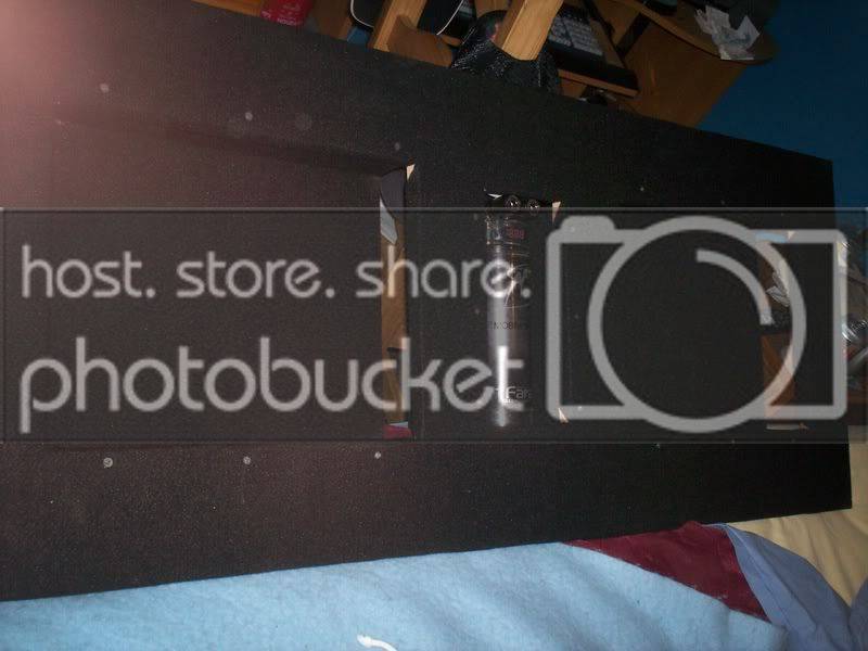

Well 2 nights ago I got this crazy idea to build an amp rack. So yesterday I went to work... Its my first so remember that when you are criticizing it... Now to the pics.....//content.invisioncic.com/y282845/emoticons/up2something.gif.dd110ecf3ae4b76050d87598f2f8de7c.gif
Only thing i dont understand is how to carpet the inside edge of the cutouts..... any help on this would be great!!!!
Not bad man for the first try.. not bad at all. Carpeting looks good.
Personally, I wouldn't have used screws, or atleast painted the screws black/bought black screws. Maybe adhesive or glue next time?
I wouldnt have used a capacitor either, but the space for it looks nice.
as simple as that is i never thought of it.... i will remember that on the box i am going to start this weekend... 5 cubes tuned to 34hz for my 12" type R's
thank you for the help
I also forgot to mention that this is also the first thing i have carpeted...
carpet like that should be streachy enough to pull in over teh corners. you just have to work it, did you even glue that area?
and you can still save the screws through the carpet. take a screw out, make a slit over the screw hole, then peel the carpet back a little to expose the wood, put teh screw back in, then fold back the carpet over the screw head.
thats a great idea i will have to try it
great job for a first time!
Thank You.... But i see alot of things that could be better... like the screws, but mostly the inside corners... dont get me wrong i am very happy with myself but theres still the little things....
