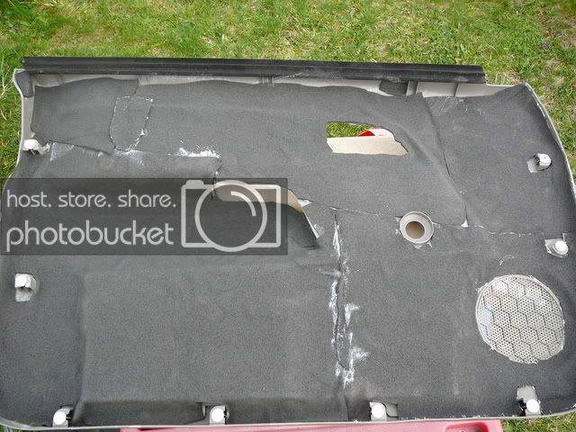

This is my Colorado build log. It was meant for sq and is my first real install.

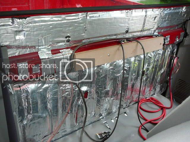

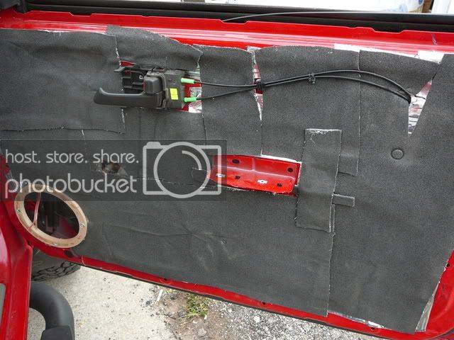

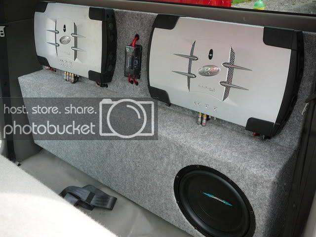

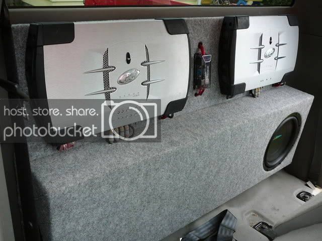

I'm running an Alpine CDA-9887 to a PG Xenon 100.4 & 600.1. I have Memphis MCSQ mids and Seas Neo's ran active. The doors and back wall are completely deadened with RAAMAudio products. I'm using an ICQ10V3 D2 in 1.3cft. tuned to 28hz for sub duty.
I still have some minor tuning issues to work out and a few things with my install to clean up, but here it is, nonetheless...
Thanks guys. Like I said, I have a few details to clean up... like the trim ring for the head unit that won't fit into the factory opening... and I plan to cover the a-pillars in matching headliner material at some point, etc.
Overall, though... I'm pretty happy with how it all turned out. I still have some tuning to do, too. Once I figure out how to use the parametric eq to it's fullest I think I'll be good to go. I may experiment with a nicer set of mids in the near future, too.

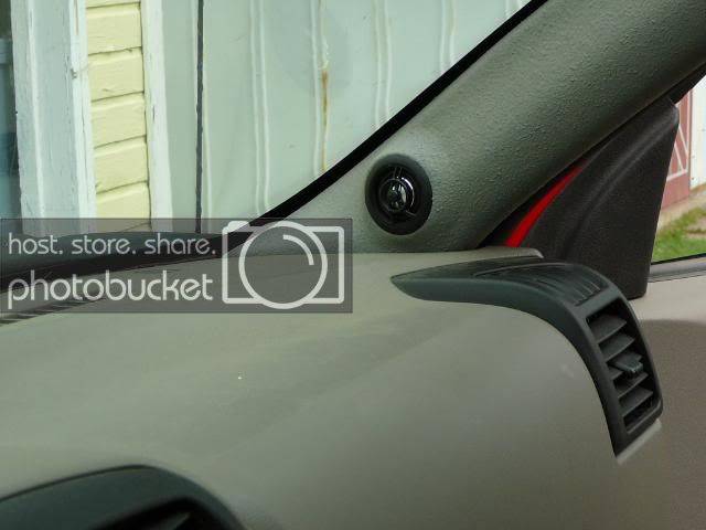

Hey man Looks sweet, I just did a build on my reg cab colorado as well. Deadened and ensolited all walls, doors, panels and floor! I am installing some kappa perfects 6.1's this week and was wondering how you integrated the tweeters into the A pillar? I am guessing you disassembled it Used a hole saw for the cutout and glassed it in?? Or maybe just glassed it in? Anyways Please let me know! Either on here or Cfans, I saw the build there as well.
