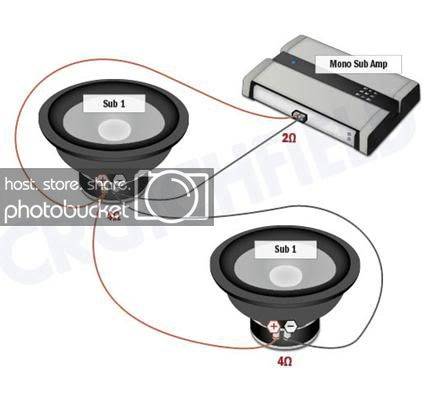

I couldn't find the exact info on your subs, but I'm wondering if your subs require more power than your amp is able to handle.
Amp
200 watts RMS x 2 at 4 ohms (250 watts RMS x 2 at 2 ohms)
500 watts RMS x 1 at 4 ohms (4-ohm stable in bridged mode)
Are you by any chance running it in bridged mode at 2ohms?
