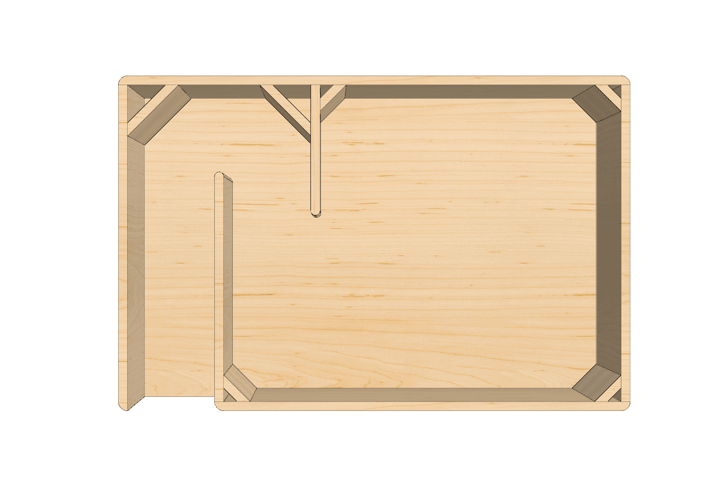

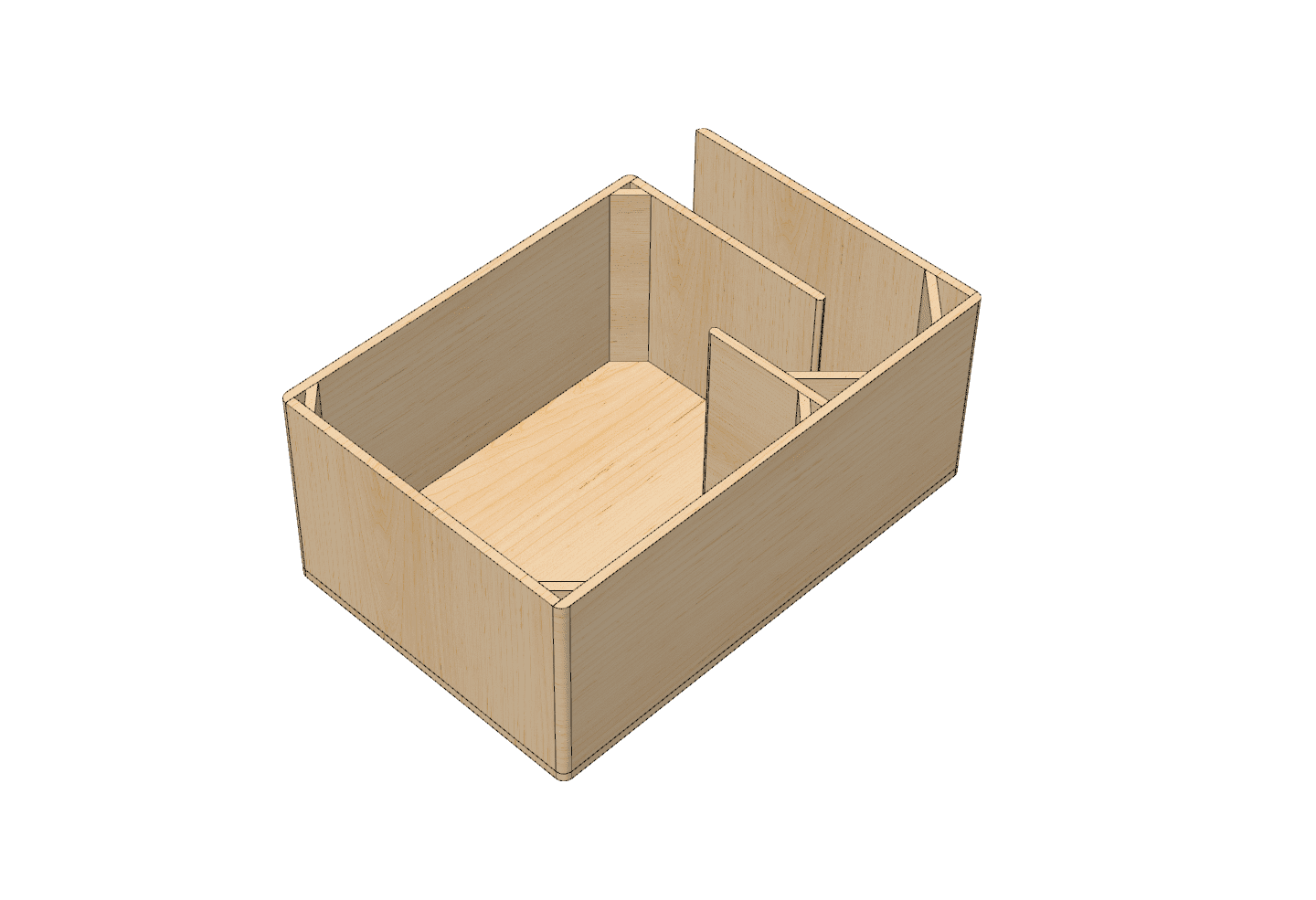

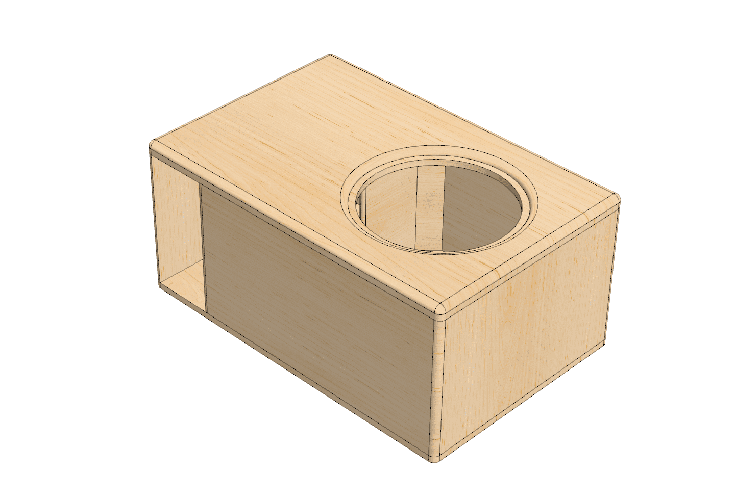

My box is currently 6cuft @ 36hz, and it's noooooo good. I have also come into possession of a table saw that I can actually cut angles with, which makes fabrication so much easier.
Either way here's the #'s
Box Dim: 41.25 x 18 x 27 ~ 9.65cuft
Port Dim: 7 x 16.5 x 37.5 ~ 2.5cuft/31hz
I figure with 45's and the sub in there it'll be right under 7 cubes.

looks solid, i like the rounded corners, nice professional touch.
thanks //content.invisioncic.com/y282845/emoticons/smile.gif.1ebc41e1811405b213edfc4622c41e27.gif
he wishes he can build as good as it looks in the pictures lol
I build just fine thanks, I took a framing square to the inside edges of my current box, before i put the top on, there was almost no wiggle anywhere, so ffffffuuuuuuuuuu

if this is for HT why not tune to about 25hz..?
I was just referring to the box as an apartment, not actually going in my apartment, lulz
I would actually tune that low if I had a maelstrom or a similar sub, but it's and HDC and it's better on higher notes
