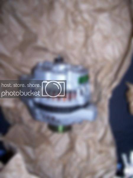

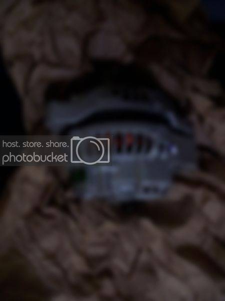

well at lunch time i went home and i saw a package sitting on my bed. i'm like wtf is this i'm not expecting anything other than an amp that i know wouldn't be here today. well i find it's my alternator so i'm like hell yeah! i open it up and take pics. so i take it to advanced auto and have them test the alt. they tested it but said there is something wrong with it. something that it wasn't charging sufficiently. the meter would jump up to 10v but not much past it. i don't know what rpm rate they tested it at but i asked if they could tell me what rpm rate it's at and if he could up the rpm rate. he said he couldn't tell but that it should be sufficient enough to make any alternator charge properly.
so i take it to Napa and ask if they could tell me if they can test the load. they tell me they will end up having a problem testing it due to it being an HO alt. that when he puts the information into their system they would end up having to set the system to rate an 05 stock civic alt with an 80amp load. but then it starts juicing 180amps it would show errors.
they recommended me to take it to another place that works on industrial vehicles and they might be able to test it's load output.
has anyone ever come across this when trying to test a high output alt at any of these comercial areas?
i have to take it to a plaec called R&R deisel. it's a place that works on alternators and marine alternators and electrical equipment along for industrial equipment. maybe they can test the alt before i put it in.

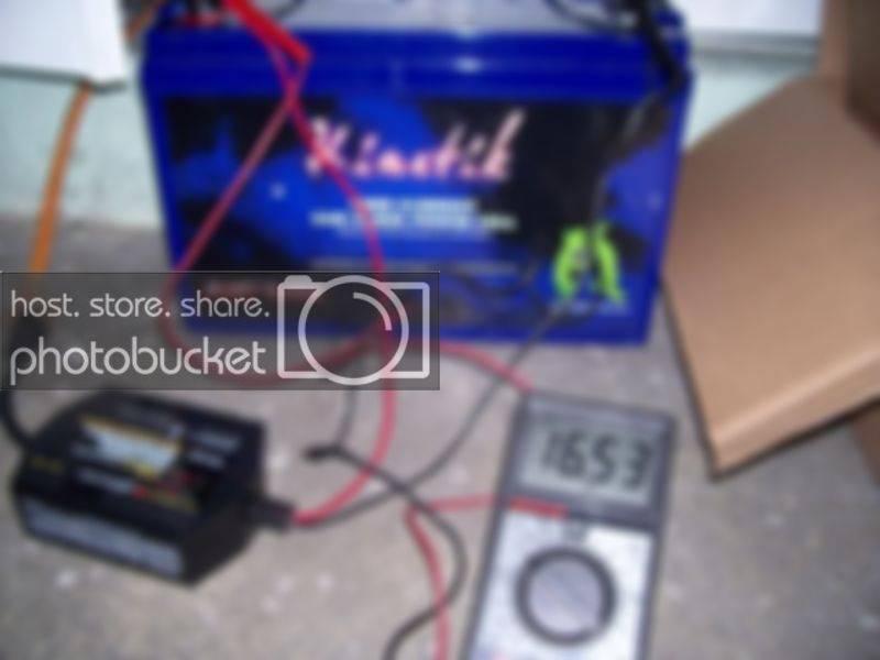

oh, i left my kinetik on the trickle charger allllll day. lol i think my multi meters off.. lol

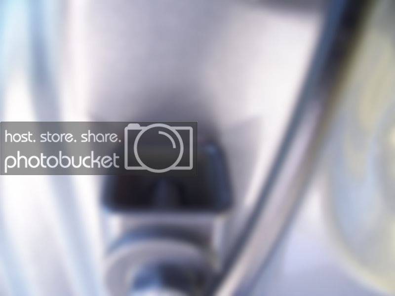

Looks great, but I do have a couple suggestions. I'm sure that rear deck rattles. Not sure if it's too late, but if you could spray some deadener on the bottom of the rear deck, get a nice few layers, it will help a good bit. Also, not sure if you deadened just the outer portion of the door or if you did the inner as well. If you didn't do the inner, I highly recommend it. As for the trunk lid, where it locks into place near the bumper there are two bolts...if you loosen those and lower the latch (will be a couple millimeters) it will help reduce rattling and keep the pressure in the trunk more.

as for the latch from where the trunk lid locks in place i have already repositioned it when i ran my XXX to reduce rattle. lol, i just got ot get more deadening to cover the trunk lid. i'm considering on using expanding foam for the inner cavities then puttings deadening on it all when it's ready. that should take care of alot of the rattle. i just gotta wait for the second tax monies to arrive.
