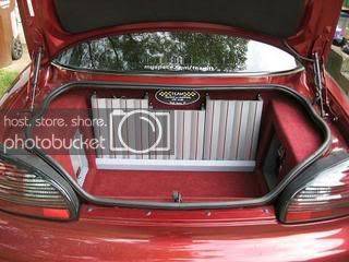

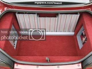

The Trunk. Sanblasted and powder coated amps.

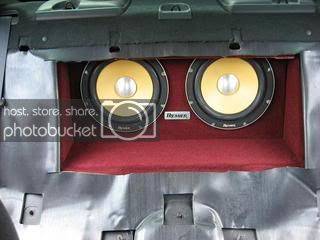

The Subs. Pioneer Premier TS-W12PRS

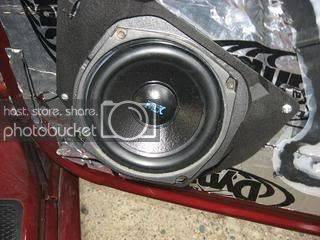

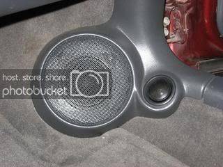

The front stage. MTX Blue Thunder 5.25s in the doors and MTX Black Gold 4" and MTX 5000 series tweeters in the kick panels.

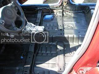

Entire floor done in Cascade spray.

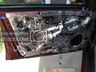

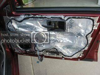

Doors done in Dynamat Extreme

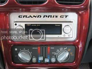

And lastly the Head unit.

Anyone know what those amps are???

I'm jealous... I've wanted those subs for a long time. I've got an all Premier setup currently, but with the newer stuff. That P9 (if that's what it is) is sick. Clean install!

Look like the older version of the pioneer subs and amps. Nice clean *** install. One of the nicer ones on this site.

Why did you choose the MTX speakers overall
I've had them for a while and loved how they sounded in my last vehicle and didn't feel like spending a bunch of money on some high priced seperates. Black Gold are some of the best drivers MTX has ever made to date. I even have a pair of Black Gold 6.5" midbass drivers that I want to eventually put in I'm going to have to mod the door skin to allow it to fit. But the Blue Thunder 5.25" drivers offer good midbass in their own right.
Nice HU and how do those subs sound? I liked em on the wall at my old work. never heard them in a proper install
These are by far the best subs I've ever run. I'm strictly an SQ guy so I don't need anything that loud. These subs have a smooth response and are very accurate and blend in with the rest of the sytem great. I have them in a dual 1 cubic foot sealed box made out of 1" MDF. I'm only giving them about 420 watts a piece.
