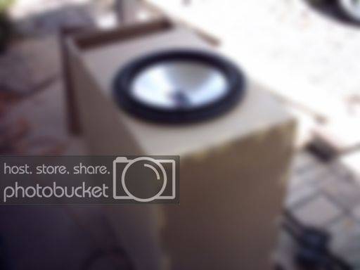

Thats a box I did for one of my team mates car's ... I dont rememeber the specs exactly but it does give you a good reference of how big it should be. This box was made for SPL though, tuned to 45 hz.

We'll the box in that picture is pretty much what i want other then the sub would be inverted, and it would prob be bigger then that but all and all that's pretty much what i was thinking for my sub, i honestly dont think the box that it's in now is big enough, so that being said could someone toss me some ideas as too how i should go about building this? Since i think i gave everyone more of an idea what im looking for now i just need answers to that question.
