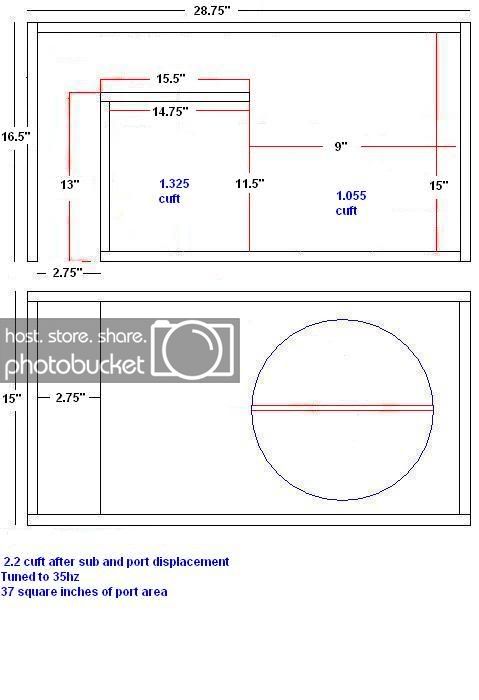

Well since no one here would help me with my box design I called up re and They told me to do 2cuft and I wanted to do 2.5 cuft so I went in the middle.
2.2Cuft after sub and port
@ 35hz
37 square inches of port area.
Here are the plans I did up.
Going to start cutting all the wood as soon as i get something in my guts.
Go bigger like 3 or 3.5
My Current box is 3 cuft after port and sub and not happy at all with the output.
It was tuned to 35hz with 50 square inches of port area.
It only did 136.3 db in that box. o and that was on a Ac not the Tl
My Current box is 3 cuft after port and sub and not happy at all with the output.It was tuned to 35hz with 50 square inches of port area.
Hmmmm i use a 2 cube box for comps tuned to 54 at 151dbs and my Daily box is 6.5 cubes tuned to 32 and does a 147. ? I found with my MT a BIG box is needed to tune low. But who knows it probably works dif. for everyone, but thats an example of what i use.
