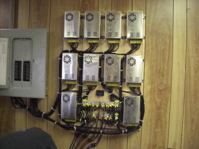

This is what we use. Ten 26 amp supplies tied together and we run it on 220v -- but these will accept 110 as well... they are cheap on e-bay and have been SUPER reliable for us as we use them every single day pretty hard.

I'll check these out on ebay. Did you just parallel all of the powers and grounds without them shutting off?

I assume you isolated each one from the others through a power diode? Schottkey maybe?

EFFF I'm guessing you can't just parallel them. I have 2 matching 950w power supplies but they shut off if I try to parallel them and run a single amp one them. What his this power diode or shottkey you speak of?
