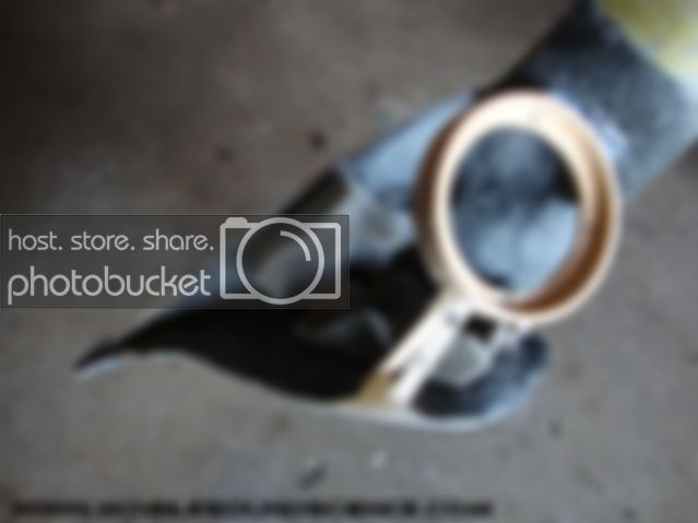

Duct seal, it's non-hardening-clay-like, but is a butyl composite. You can probably add some CLD tiles to some spots on the enclosure before adding on the duct seal. It can be found in your local Home Depot or Lowes in the electrical section, where the connectors, loom, zipties are. I did something similar with my pillars/dash:
