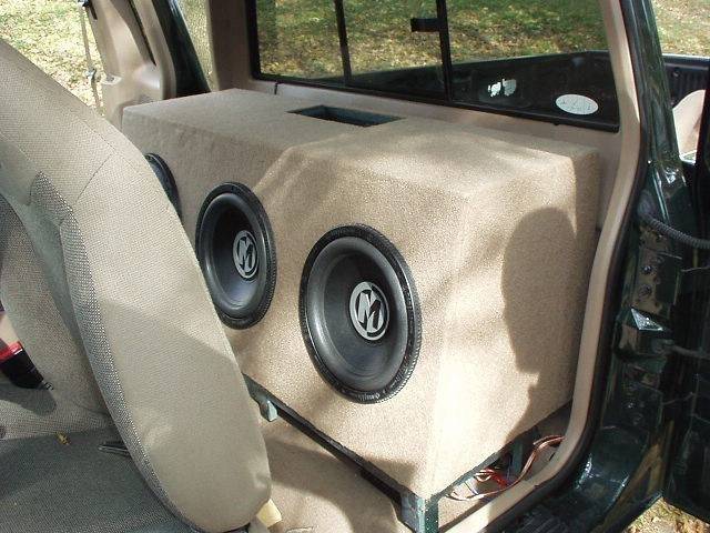

but i agree with the 2 12's ported memphis pr idea. 2 cubes each tuned to 34hz...yep...nasty baby. here's a quick pick of a three 12 memphis pr setup off a mtx1501d....this truck is sick loud.

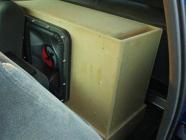

and my truck, just for giggles...
though it looks a tad but different now..lol...

mrray, that's a nice install with those 3 12's did you do it? Also I'm going to run 3 15" PR's.... You suggest any amps? They will be ported. Everyone tells me on here that the 3 15" PR's wont touch 2 L7 15's, but I think they will due to more cone area.
yeah, i did that install.....and with the way u posted ur other thread, i think the L7's would win as well..lol....even witht he added cone area, ur giving the L7's double the power....
but if that's the way u want o proceed....if u can match impedence (or real close) those three twleves are pushed by an mtx 1501d..it is sick loud.

So considering your saying those 3 PR 12's are sick loud, and it looks like their sealed. What do you think about 3 PR 15's ported.
not sealed, look at the top of the box....big dark square....almost 70in^2 of port...6ft^3 box tuned to 34hz....
three 15" pr's ported with the right power would indeed be very loud.
