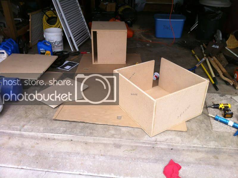

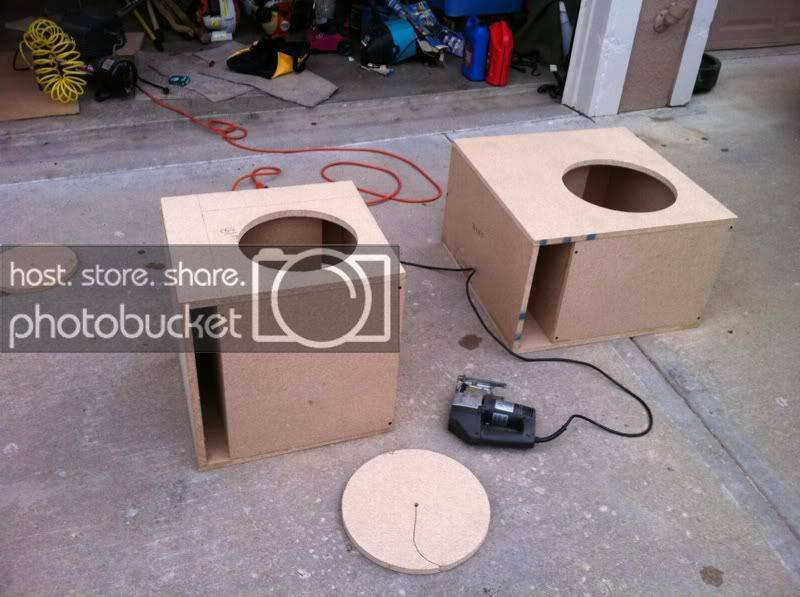

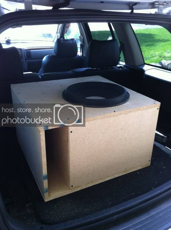

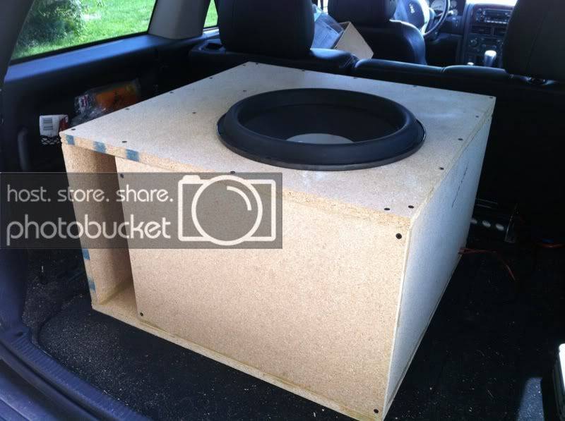

Build update. Test box #1 is 3.5 cu. @32 hz 64 inches of port area.

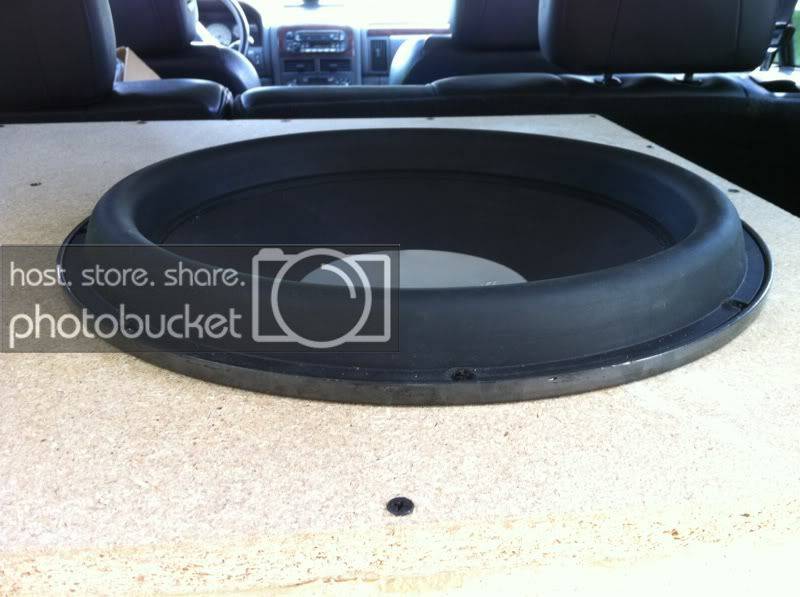

Oh and what's a good way to get the oxidation off of the motor? It's got a lot around the top of the motor
Brasso. It can be found in your local grocery stores cleaning chemicals. Be careful not to us a brilo pad or anything. It will put find scratches in that hurt more than help.
