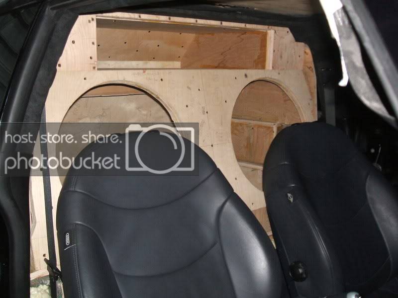

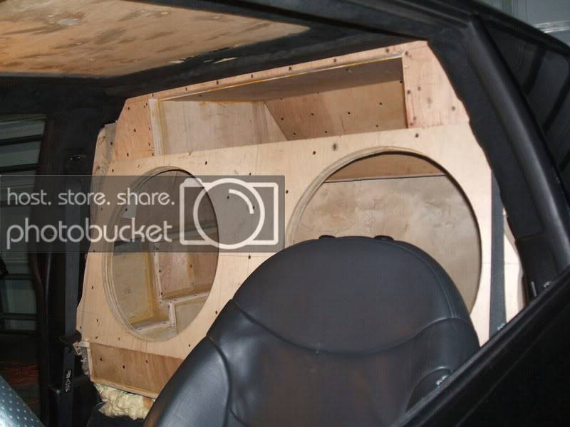

mini cooper, wall, 2 18" mts, 6kw

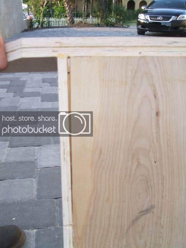

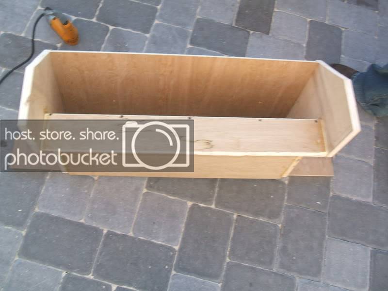

couldnt really avoid this, but it will be completely sealed and hidden. all will be good.

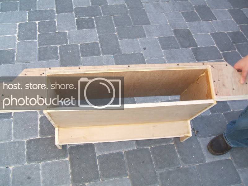

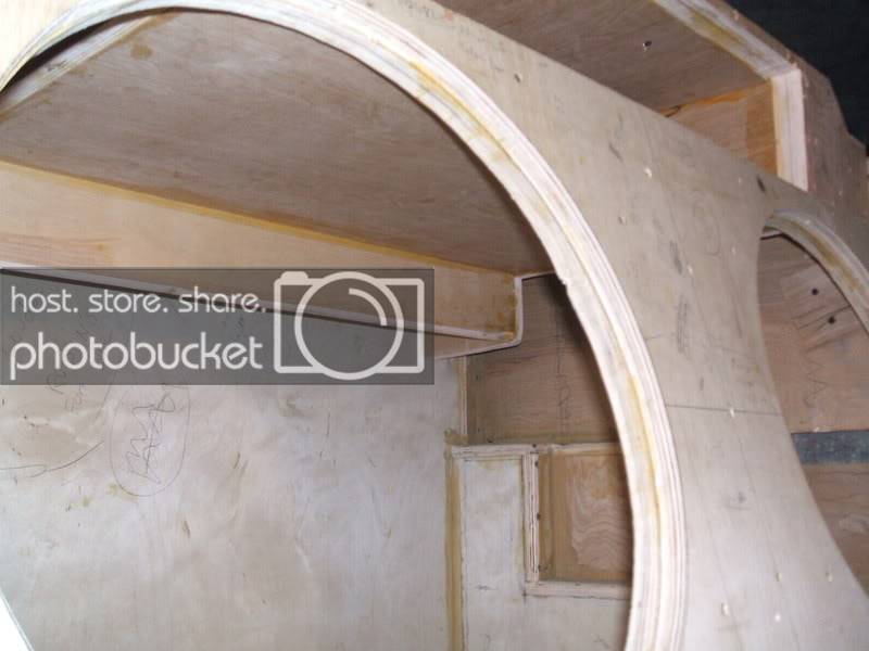

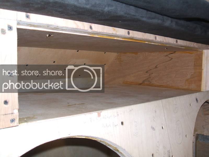

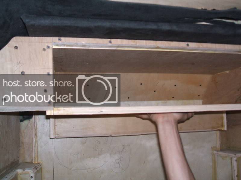

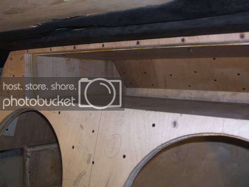

now its 5.75" x 28.25", for 162 square inches of port. with the port, the NET airspace the subs will see is around 12.5-13 cubes i believe. thats approx. could be less, could be more...
I think that means.. he doesn't know exactly what it's tuned to??
no.

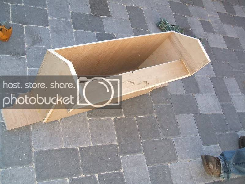

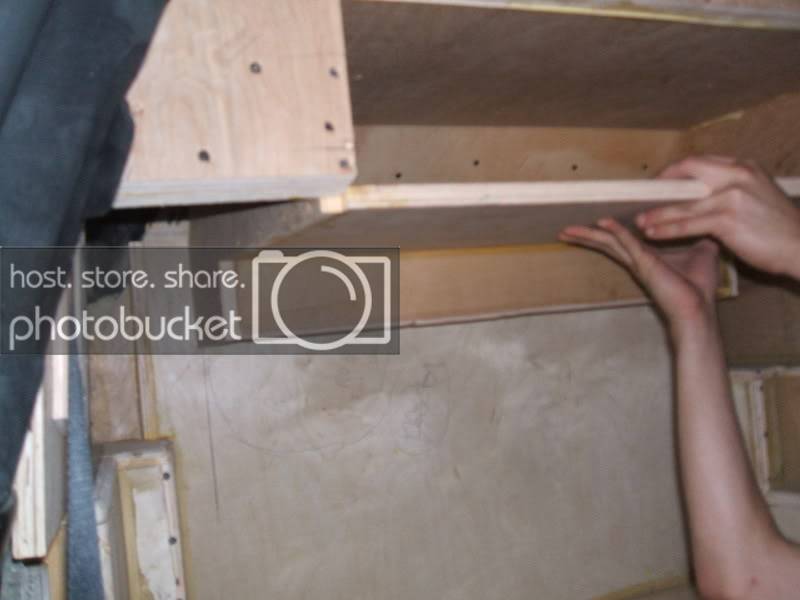

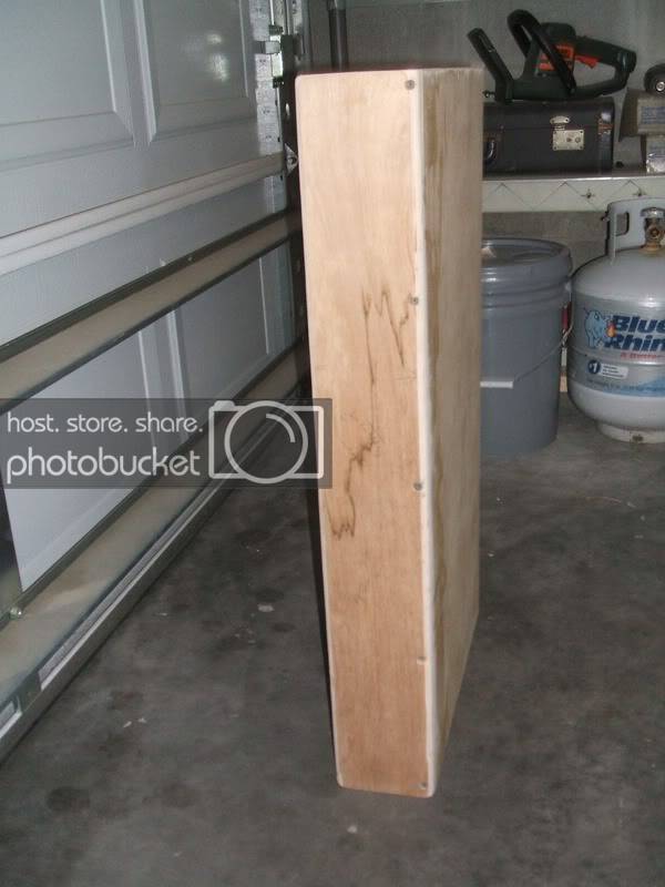

im gonna use 45s on the side. its not gonna be nearly as hard as i thought.

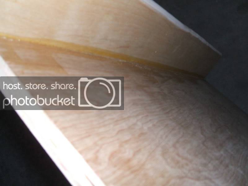

**** glassing it. ill resin over the wood, i dont feel like actually glassing those gaps though. id rather have it sealed with wood.
