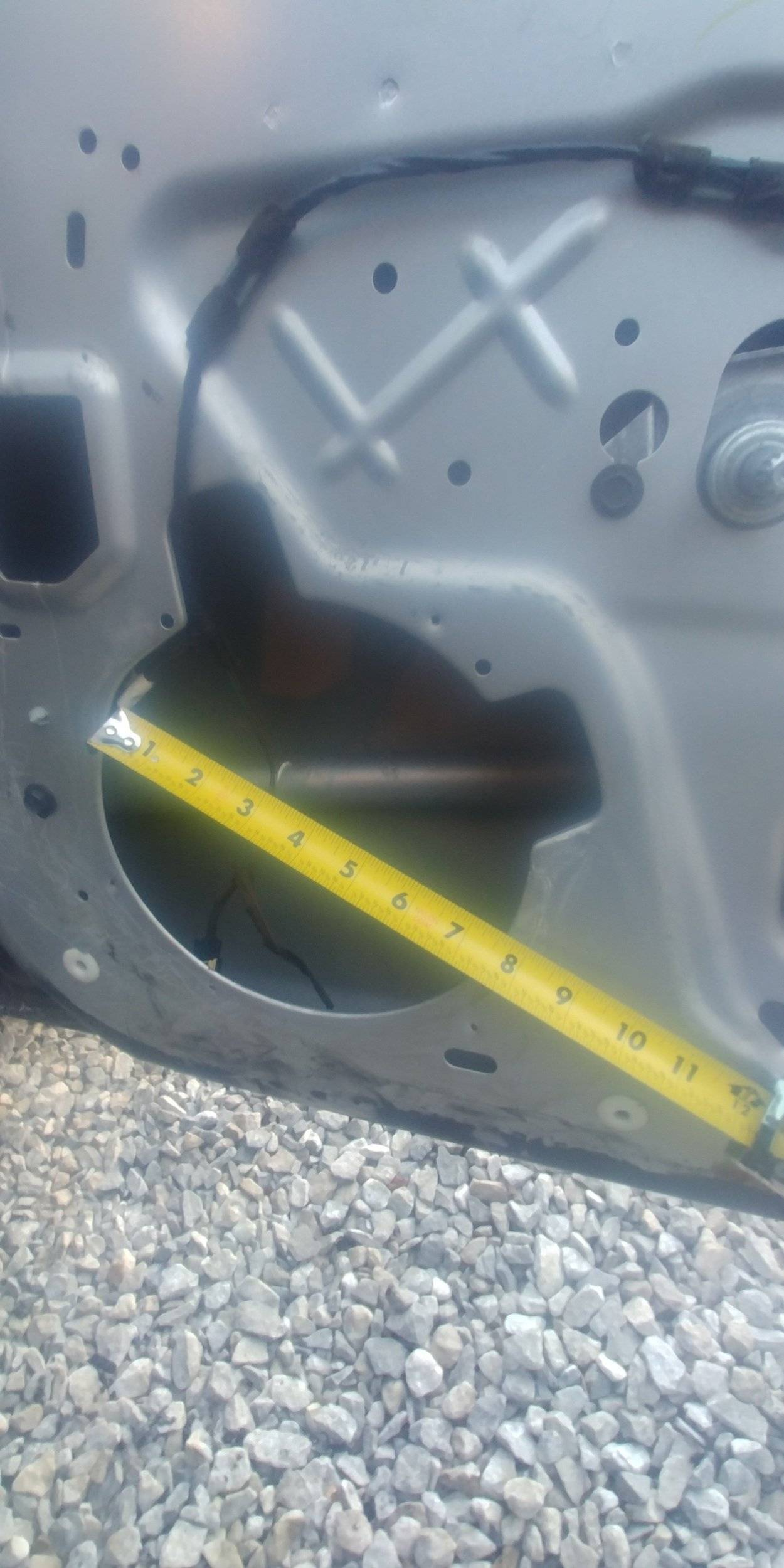

I got into my door panel today and could see that I think I have space to install an 8" mid driver in the door instead of the 6.5". Pioneer has an 8" driver in this same line that I could use. It is 180w RMS.
I would need to put a 3/4" thick baffle over the hole to get the depth clearance I need but it looks like my door card will still have room to go back on if I do that.

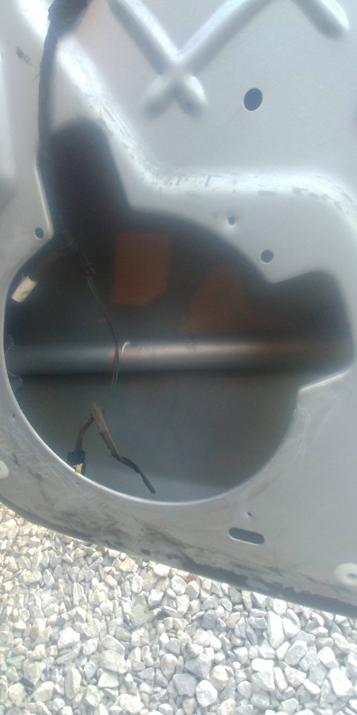

Additionally,
I bought foam rings to go with the speaker install.
They give you a solid foam circle to install behind the speaker on the outer door skin but as you can see from my picture, the crash bar is right behind the speaker location.
18634
18633
Should I just cut the thing up and go around the crash bar? Maybe try to glue it over top of it?

as for the speed rings, cutting them around the crash bar will nullify their intended use, so it would be my advice to modify the baffle and door card to get them to fit unmolested.
