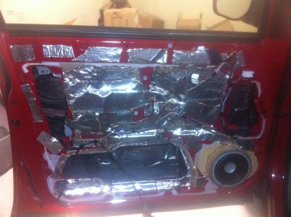

I agree that deadening willh help, and sealing the door openings and adding proper seals is crucial for midbass. In your seat you are hearing the front and back wave at the same time (due to lack of seals) so you don't hear midbass. To obtain good midbass Sealing your doors is #1 and #2. That is seal the door openings and seal around the speaker. Deadener is #3.

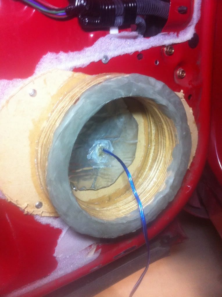

Would door pods negate the need for deadening since a pod would be acting as the enclosure?
yes. Like he said, you need to seal the holes in your doors with something rigid ( i use deadener on top of thin sheet aluminum). The deadener adds mass to the door panels to prevent vibrations and rattles. That probably wont be an issue with kick pods so you probably wont need deadener on the doors.
the thing to worry about here would be enclosure volume. Car audio midbass drivers are designed to perform IB, so a simple pod wont perform as well as a sealed door. You can maybe make pods work, but you'll need a good bit of power to get the same amount of output you would in your door IB and that still may not yield the same results.

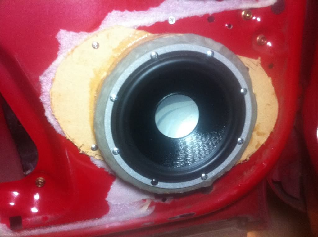

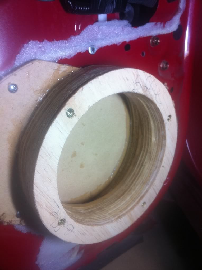

Yea, door pods are not always sealed enclosures, just rings like pictured above. As long as the speaker uses the door for airspace, the doors should be sealed. It's akin to holding a woofer in your hand and playing it, you don't hear bass because the front and rear waves cancel. The enclosure isolates the front and rear wave. Allowing you to hear just one. The result is midbass. True for home, pro, and car audio.
Over the past two decades I have heard a lot of complaints that the aftermarket speakers have less bass than factory. The cause is always seals. The factory speaker will perfectly seal against the door panel, essentially using the door panel as the front baffle. Airtight is the key. I put foam on the front and rer of every door speaker to recreate those seals.
it could, but the thing to worry about here would be enclosure volume. Car audio midbass drivers are designed to perform IB, so a pod, if not large enough, wont perform as well as a sealed door. You can make smaller pods work, but you'll need a good bit of power to get the same amount of output you would in your door IB and that still may not yield the same results.

shouldnt be terribly expensive...you could just get some sheet metal or some wood and cover those holes. Audio Technix makes some nice budget deadener you could use.
