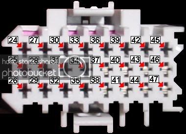

The thing is my plug does not match what this picture depicts:
Left Rear + Input 37 BK
Left Rear - Input 38 WT
Right Rear - Input 40 BN
Right Rear + Input 41 BK
Left Front + Input 43 YW
Left Front - Input 44 BK
Right Front - Input 46 GN
Right Front + Input 47 BK
The harness will not work if my plug is incorrect, think about it. I only need the front outputs so,
The picture states pin 46 should be RF- (GN) and pin 47 RF+ (BK) but mine is reversed from this. If I use a harness, it would assume 47 is BK + but mine is GN.
I don't know if I should go with color as polarity or placement.
How can I figure this out?
Well I ended up buying the tools from Walmart, 2 sets, pulling the radio and getting the correct wire color/placements from the back of the head unit itself. Turns out in my case the GN wire is in the wrong location at the plug (pin47) in the rear. All colored wires are + and the black wires - regardless of pin location.
