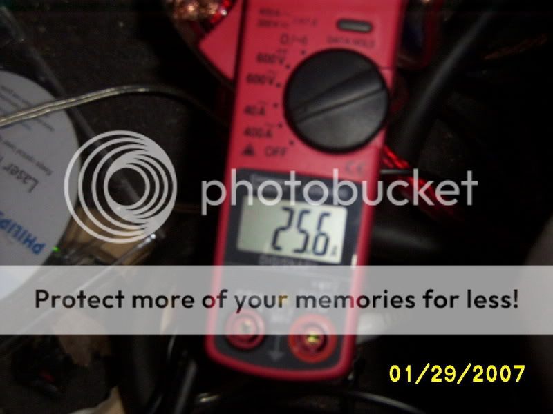

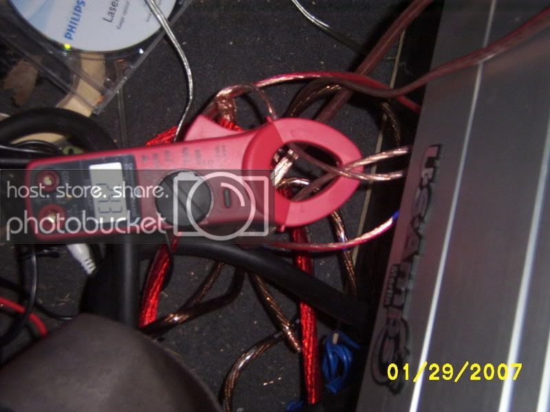

It was going into protect after shot ammounts of playing time. It was not thermal (wasnt getting warm) and switching RCA's didnt do anything and I checked everything else. Before it was running at 0.5ohm no problem. Today it still wont run at 0.5ohm but it will run at 1ohm for as long as I tested it.
It isnt acting up for burps at all. dleccord requested (you have them in PM BTW) and I figured I'd post here for good measure.
It started out with 30a but my cam is slow to turn on so this is 6sec into the burp (vehicle off) before the higher one was taken and a full 10 or so before the 2nd.
